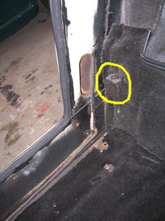

The top bows originally are a 1-piece unit. There are 2 sets of holes for the bows: 1 near the top of the car, for when you are using the top, and 1 near the floor. If you tip the seats forwards you should be able to see them. I've circled it on the attached picture.

There are no storage holes for the top bow on this BugEye. They might have been removed prior to getting it in 1968.
I have seen those storage mounts on eBay for cheep.
correct me if I am wrong, but wasn't the original jack "T" shaped, with a simple ratchet "spanner" that fit on top? And jack, I believe the earliest (58?) hood frames were one piece, but later ones came apart in the middle. Both will fit in the "holder" shown in the picture above. Remember to compress the springs, stow, or install top (which ever you are doing), and then release springs to seat stays in channel behind rear cockpit molding, or to tauten top. It is supposed to stop it from rattling around but only minimizes rattles - eliminate rattles by adding some foam padding (like self adhesive weatherstrip from Home Depot) forward edge channel. I also found that a Velcro band wrapped around the middle keeps those parts from rattling against each other too!

My BE doesnt have the lower storage brackets either. But there is no sheetmetal left where they should be. If someone can shoot a good closeup pic of this, could get me started on duplicating a pair.
