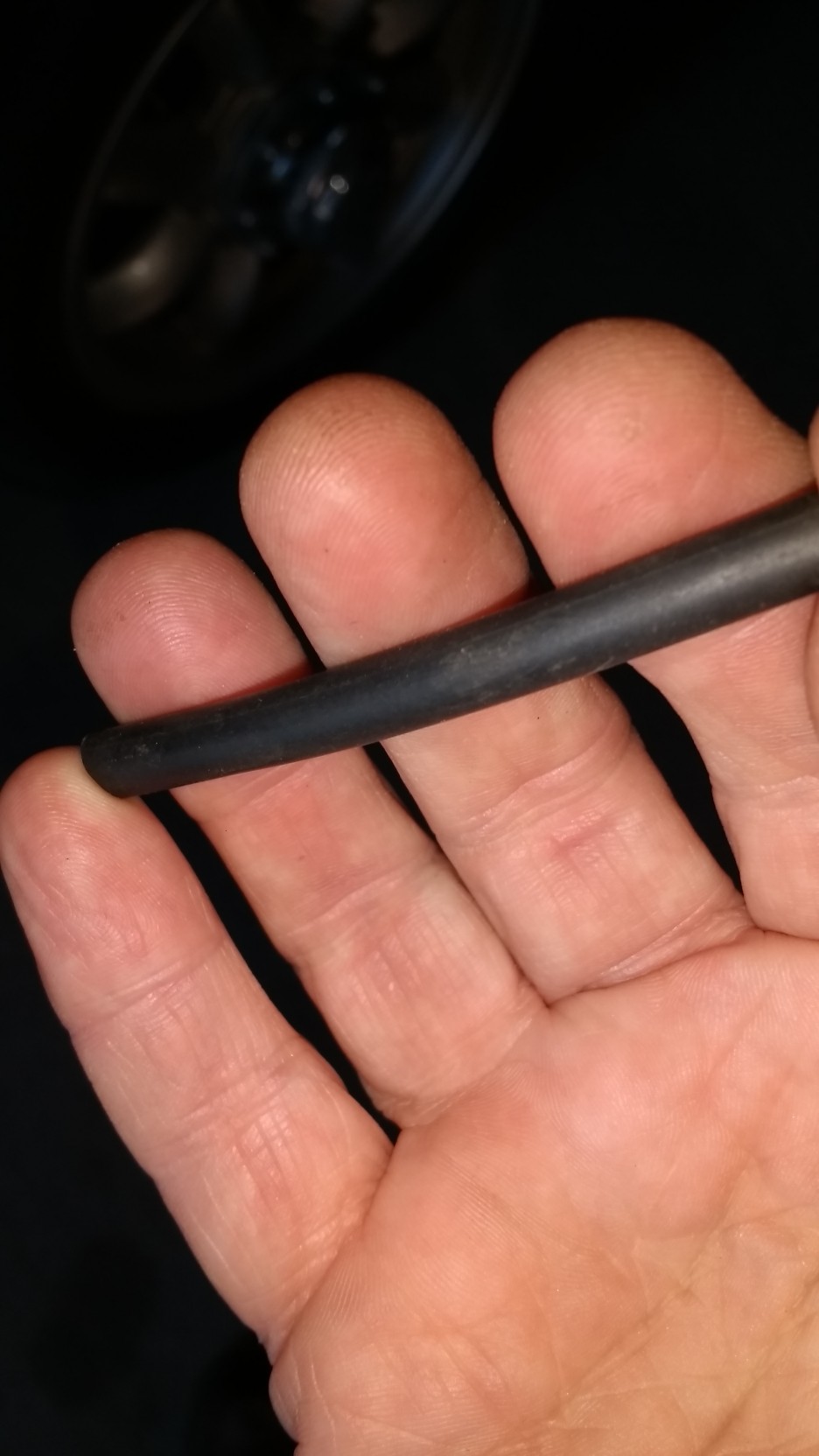

A porsche mechanic had "extra" in his shop. Perfect match!! (shrink wrap would not work as it is not "Concours" quality. Contra to original semi-gloss, the shrink wrap is a matt finish. Further the "shrink" would clearly show a difference.
