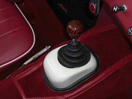

I just finished up a 5-speed conversion from BillM, and the stock shifter bucket would not work, as the shifter would not engage in the 1-3-5 gears. So I did what any resourceful guy would do, go at it with the grinder! I used the MGB gaitor, as shown below.
Scott in CA

Is that the stock Datsun lever, but shortened?
Doug

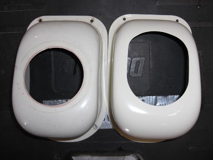

This has come up before. This time I took a pic. (hope it goes)..I cut 1" out of the height of the can, filled in hole completely, then re-cut it as far forward as I could. I tried a Big Healey shift boot but it kept popping out too, so I went to this from some British car.
