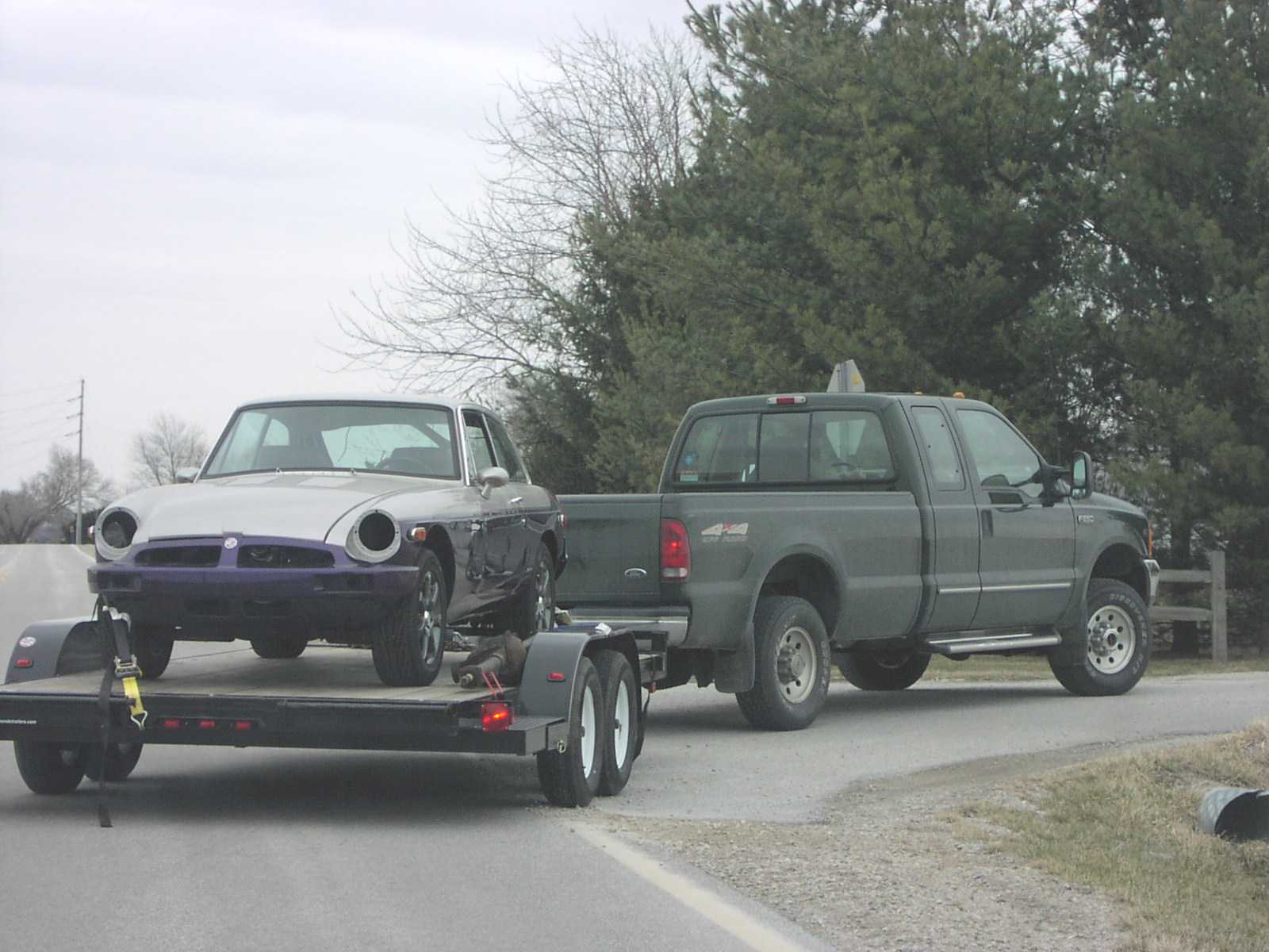

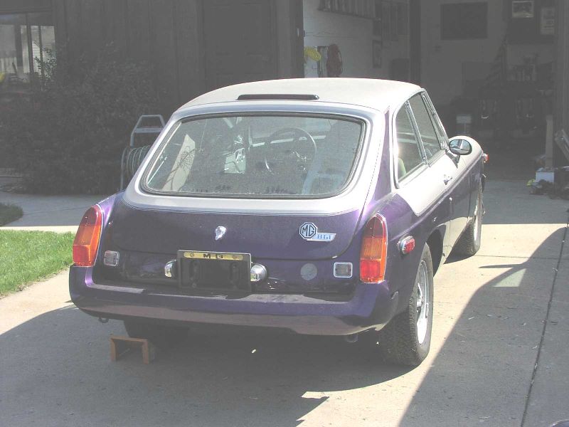

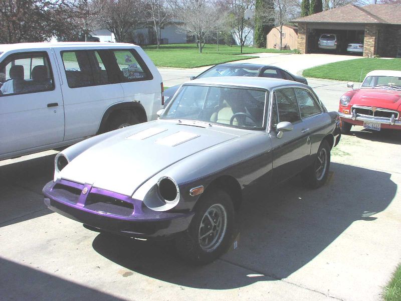

Personally, I think the rubber bumpers fit rather well on the GT..and looks better than those on the tourer..although I would also advise against this "futuro-grade" (opposite of retro-grade). I have a buddy with a parts B/GT that has had a r/b installed on the front, retaining the c/b on the rear. Looks rather odd.
Here's my 1974-1/2 GT...

That doesn't look too terrible at all Rick, thanks for the pics. The minilites help the overall look, but the bumpers look like the late 70's GTs in the UK.
Those are what I remember most.
Anyway, advice taken.
