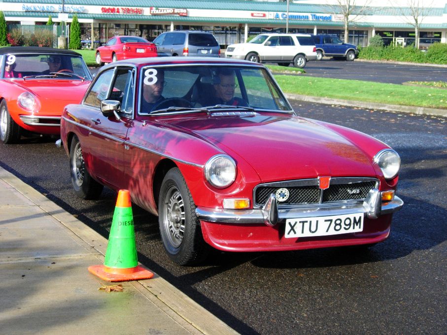

Hi all, I have an MGB-GT V8 (original, factory-produced that way), that has had a gearbox swap to the Rover 5-speed that was used in the Rover cars with that same 3.5-liter Rover V8 engine. I'm looking for a source for a similar, rebuilt gearbox to replace mine. Other than getting one from overseas, which would probably entail sticker-shock shipping charges, does anyone know of a source for these? Thanks.
