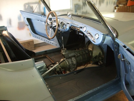

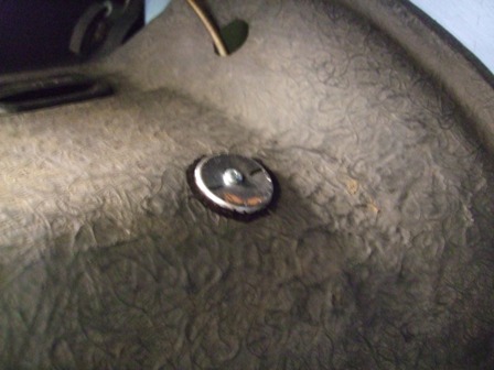

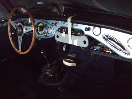

Chet, I don't know what is original for a BN6 but here is what I did with my BJ7. see Pics:

I found my BN7 speedo cable "trapped" between what Moss calls the gear box extension panel and the gearbox cover. Freeing the cable required removal of the seats, carpet, transmission cover, etc. When I installed a replacement cable, I drilled a hole quite similar in location to the one visible in vette's center photo above (near the top). I, of course, minimized the diameter of the hole and installed a grommet. The cable now comes up behind the the top of the carpet at the point pretty much illustrated in the mentioned photo and wends into the speedo. I can remove it in minutes. My car is a Smitty Toyota conversion, so I am automatically freed from some of the restraints those with concours requirements or owners determined to maintain originality. Might add that I chose not to use the right-angle adapter Toyota sells to provide a more direct route away from where the cable plugs into the gear box. I chose, instead, to buy a slightly longer cable that allowed a gentle bend away from the box. The big challenge was attaching the fitting required by the Toyota box to a Healey cable. I know this because I first didn't shorten the cable enough to allow it to attach at the speedo, requiring a redo. On the topic of Smitty conversions, our Healey club just accomplished the installation of a 3.545 ring and pinion set sourced from SC Parts in the UK in my car. So far it is very quiet and my drive train now gives me right at 66 mph at 3000 rpm compared to 59 mph with the old 3.909 ring and pinion measured with my GPS. I have no idea which of the innumerable Toyota gear boxes is installed in my car, but for all that is operates beautifully. My expense, including about $280 to have the gears professionally installed in a loaner differential, was perhaps $900.

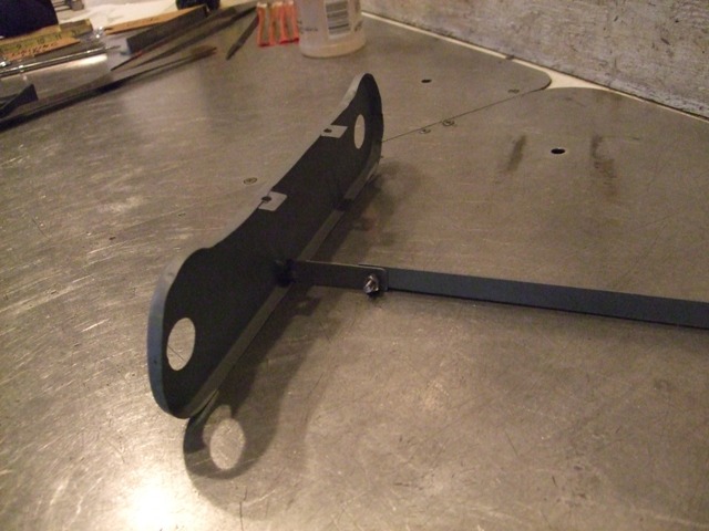

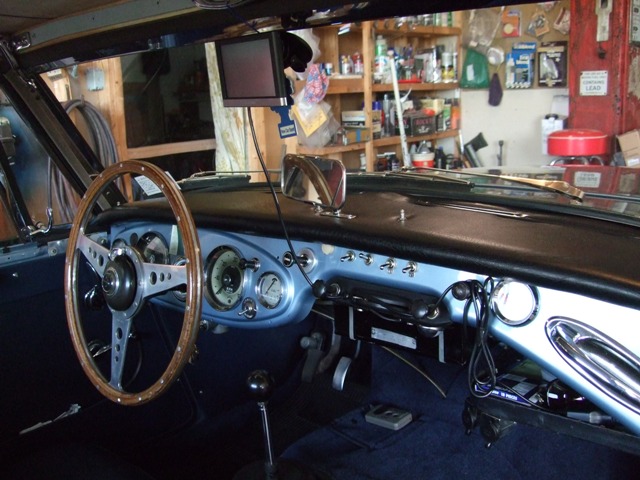

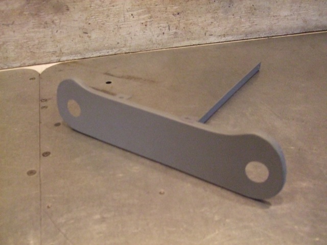

Rick, I was making an auxilary panel for a radio and then some aux power plugs for the GPS and I-Pad. But I decided not to install a radio. 'ell, wouldn't be able to hear it anyway above the sound of those outrageous pipes. (Good Sound though). Can't hear the wife talking hardly at speed. {that's a good sound too, :smile: } I was thinking of buying a set of radio head phones to use while were cruising then I thought what am I nuts...
So I installed the aux power plugs on the bottom of the parcel shelf an put the new panel away for another time. Here's pics of the aux panel and then one of what the dash looks like now.
