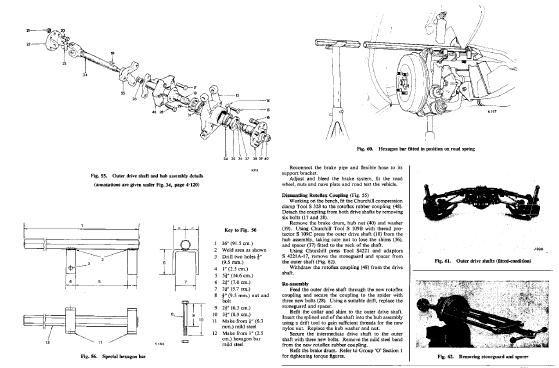

One of my first jobs when I started work at the shop was to swap out the Rotoflexes on a GT6, so I know a bit about them. Like Bob said, the hardest part is getting the suspension up, but we created a reletively easy and pain free way to do it. What you need is a piece of 1 inch square tubing (about 2 or 2.5 feet long will do) and 2 large D-shaped brackets. I'm not sure exactly what these are called, but it's a U shaped piece of ~1/4inch round metal, with threaded ends, and another flat piece of metal goes across the open end and is held on with bolts. The whole thing is probably 3 or 4 inches from the top to the bottom of the U. If you hook these D-brackets together and put them on the square tubing, and then put one (the one that's not directly touching the tubing) onto the axle, or leaf spring (I don't recall exactly what part) and then place the tubing on top of the piece that needs to be lifted up, and have someone pull up hard on the tubing, the suspension will compress. Once someone has pulled it up a sufficient amount, get a 2x4 and place it vertically under the tubing to hold it up.
I know that's a horrible explanation of the way we did it, but that was 3 months ago, so I don't remember all the details. I imagine if you look and experiment a bit you'll figure it out. It was done with the car up on jack stands. BE CAREFUL WITH THE TUBING AND 2X4!!!! THERE IS A LOT OF PRESSURE ON IT AND IT WILL SNAP OUT QUICKLY IF YOU HIT THE BOARD OUT FROM UNDERNEATH IT!
Webbs absolutely correct - I tried to sidestep making the correct tool and instead employed a weightlifter buddy of mine to pry on the leafspring with a long prybar - He almost flipped the car off the jackstands and still couldn't get the spring high enough to tilt the vertical link up and line up the bolt!
But being as I'm home now I broke out the jolly old Bentley manual and made a scan of the special tool schematic and the procedure for dismantling and replacing the rotoflex coupling - If you need the full procedure for removing and dismantling the halfshaft assembly and hub email me off forum - email address is available in my profile - and I'll scanit, pan it and send it over. ( Mind you - that's my work email so it may be a few hours before I respond - Manual's at home) ps this is a large file dimensionally if you print it out you'll need 11x17 paper - I'd just zoom in and pan around and take notes!

Mikey - The scan I sent is what Webb describes in his email -it attaches to the leasf spring and can be held in place by a jack stand - The reason it works is where it attaches to the spring - way out near the end - thusly employing the spring;s attachment to the hypoid unit as an effective fulcrum - trying to use a prybar there's no place to get the corect purchase on the darn spring - So save yourself some skin and aggrevation - BUILD THIS TOOL! - won't cost more than a couple bucks in scrap steel and a little welding.
I looked at the jpeg I attached - may or maynot be good enough quality - If not send me an email off forum and I'll attach some high quality jpeg's to the email and return it to you.
Bob M.
