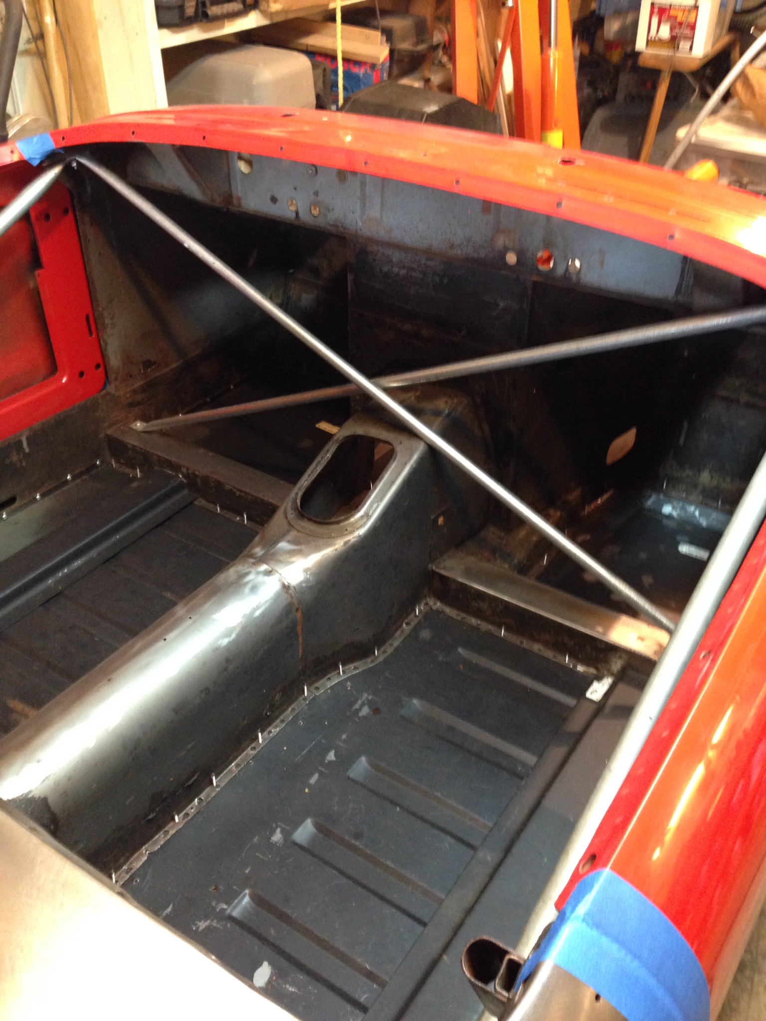

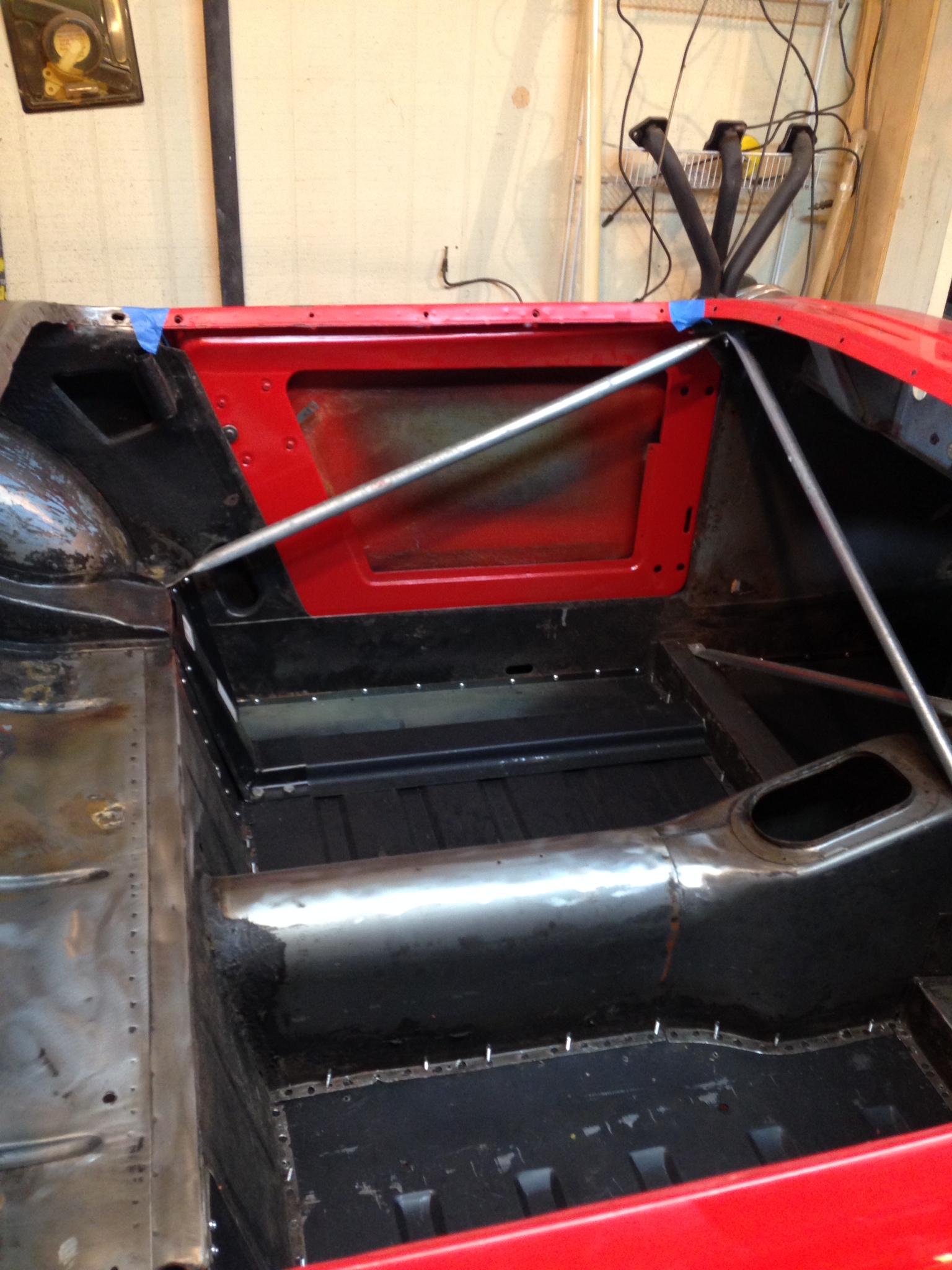

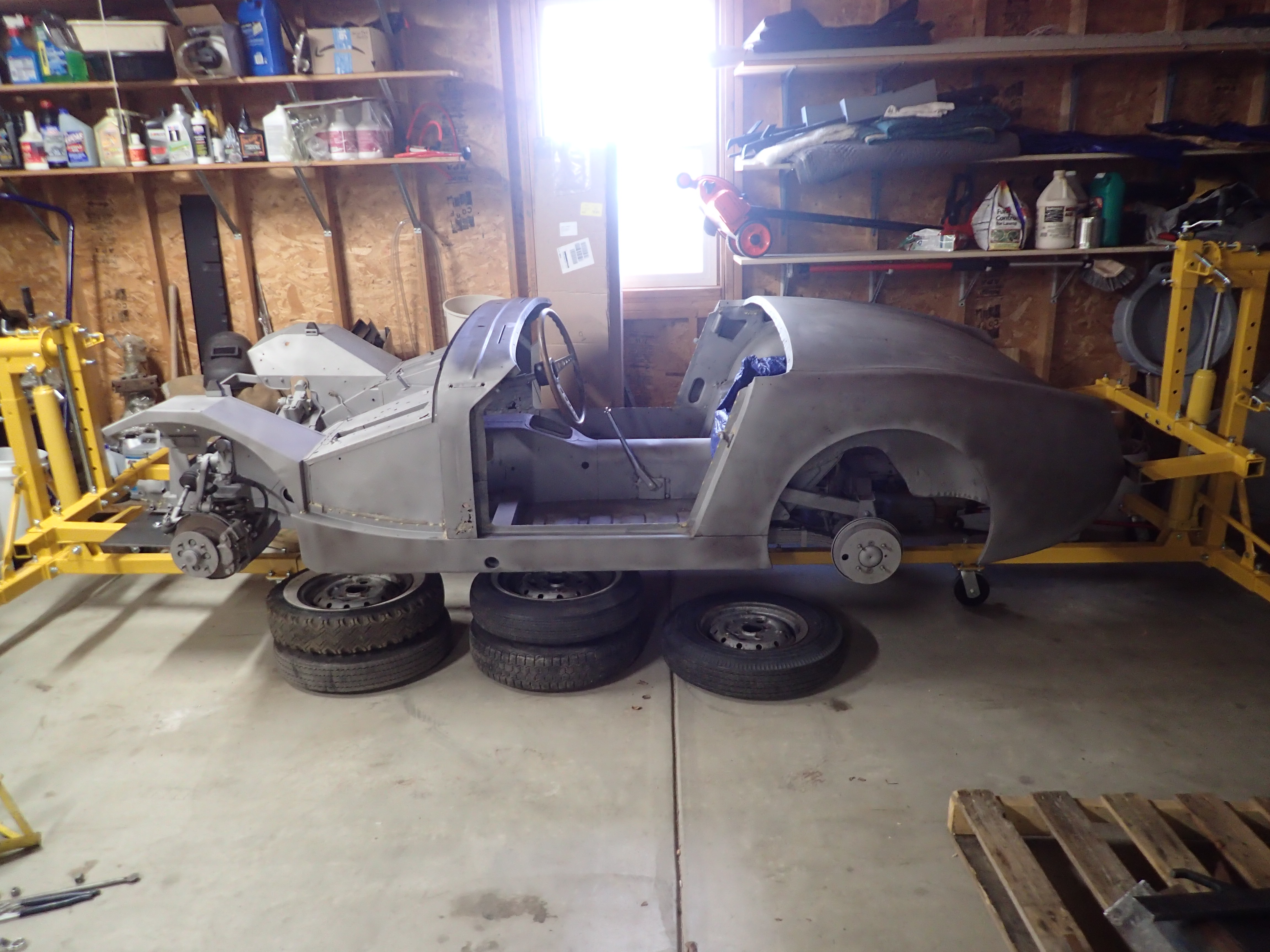

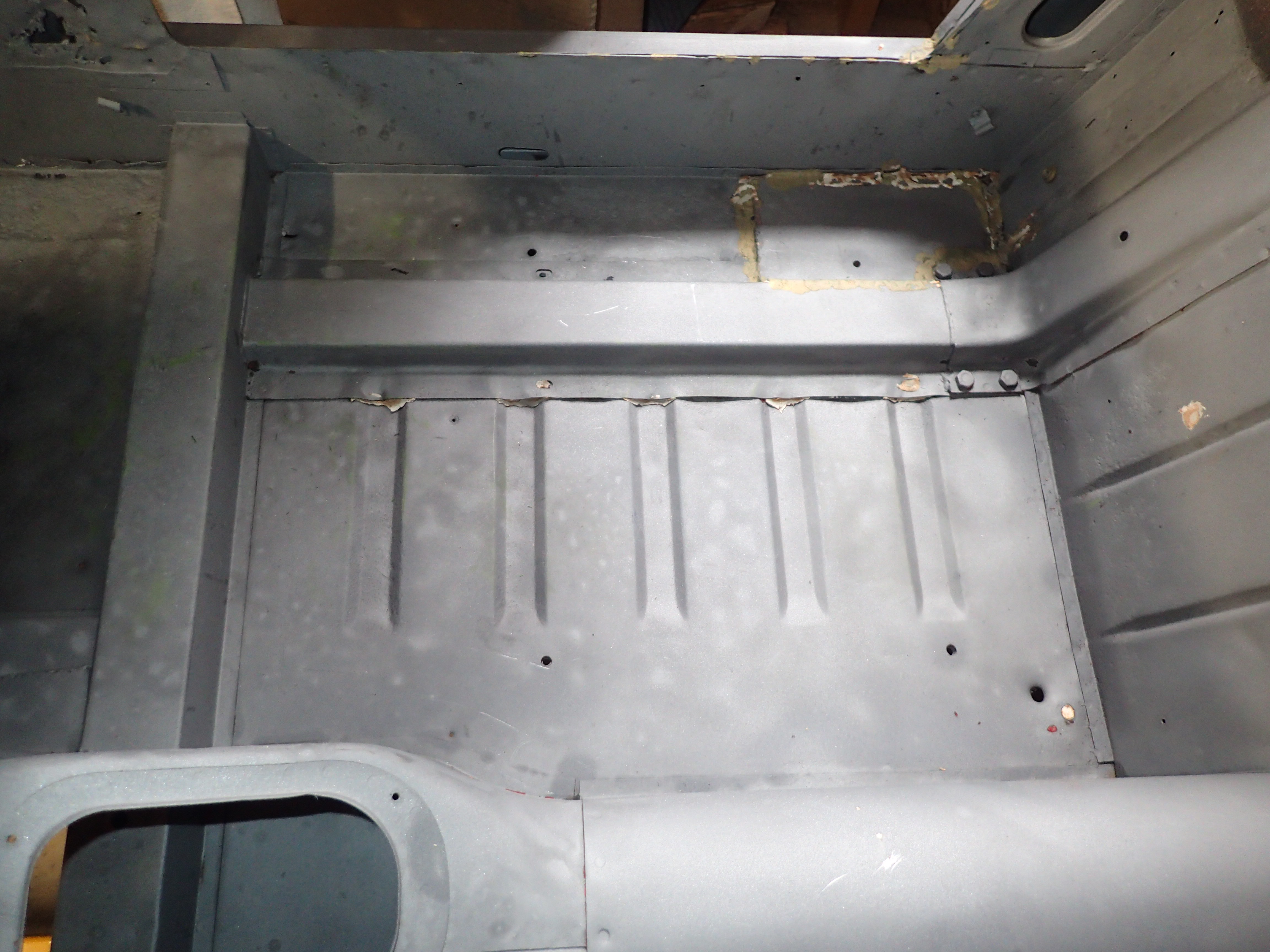

On a BE I am wondering that if I peel off the floor pans (they are Swiss cheese in some places) and leave the doors off does this thing have enough structural integrity to not collapse under it's own weight? It's east to put the doors back on if they help, but they limit access a little. I have new floor pans to MIG weld on after removing the old ones.
