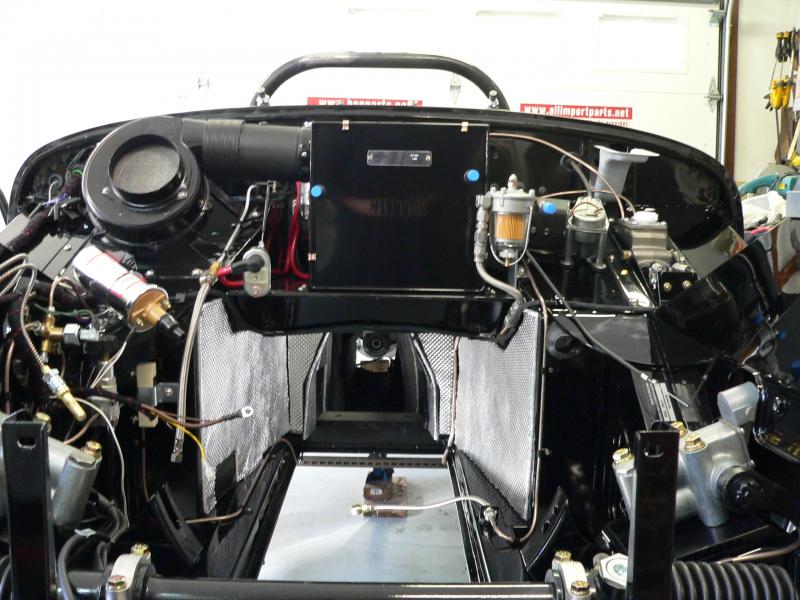

If your seeking centerline of rotation for building your rotisserie? Here's a photo of mine which I aimed for the center of deferential.
