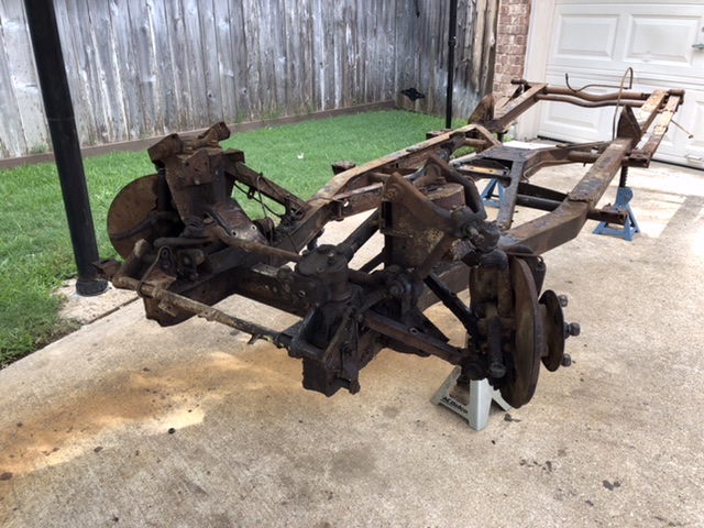

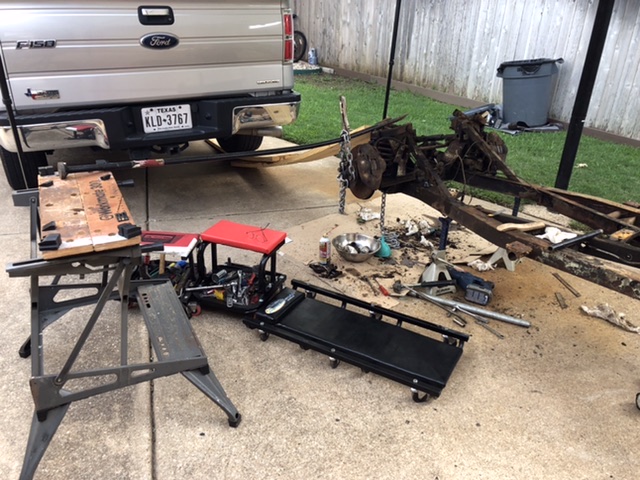

So, what I’ve learned so far, is that before lifting the car off the ground, FIRST, remove the front suspension snubbers. Speaking with Yoda John, he told me this AFTER, I had the car on jack stands with the wheels removed.
He told me, once the weight is off the suspension you will not be able to get to the lower shock mounts to remove the shocks. With the shocks installed you can’t remove the coil springs to begin your front suspension work.

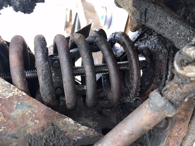

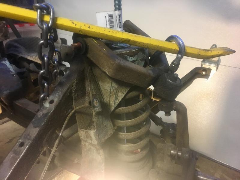

This became obvious ONLY when I tried to compress the springs with a pry bar for leverage, the front of the frame would lift up off the jack stand. After a lot of head scratching I came up with a plan. A bit of weight provided by my F150 and the application of the pry bar, I was then able to compress the springs enough to get to the snubber AND shock bolts off. Now the pieces of the CUT UP shock came tumbling out to lower control arm hole.
Now I’m in the market for a coil spring compressor so I can remove the springs. Harbor Freight, here I come.
I’d like to thank John for his suggestions to cut out the shock, and his guidance in this endeavor!
Here are a few pictures for your amusement.
Sweating it out in TX, Joe
9087894E-353C-4273-A46E-640ED31CF15C.jpeg53F17DBC-DF64-4769-BA2C-4B17C2F1D3F7.jpeg84E3EC89-9D6C-495B-8B47-2C18189629FD.jpeg

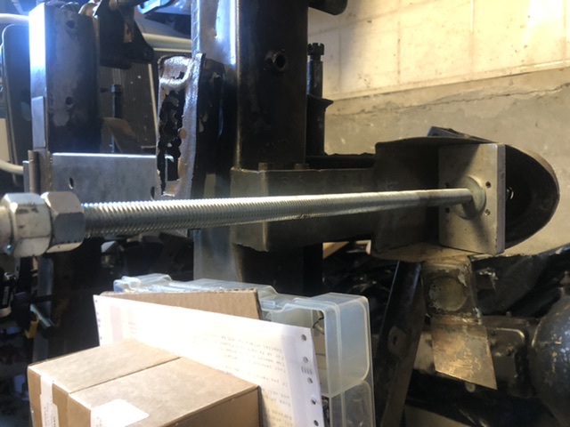

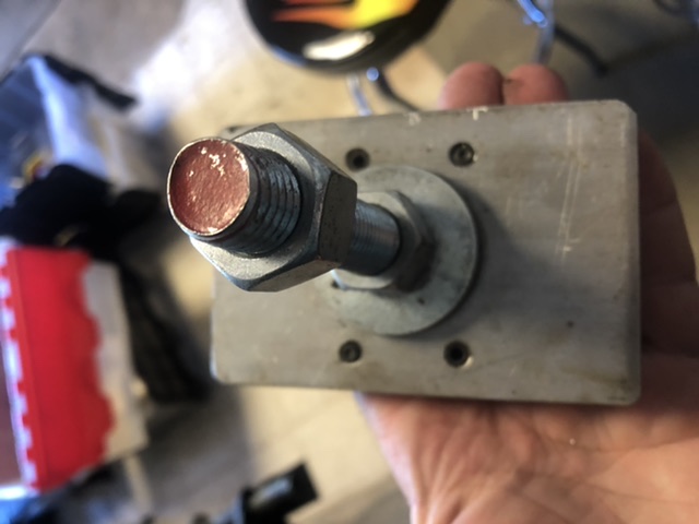

I've used a length of 1/2" threaded rod with plates on either end. It fits into the spring where the shock once was. Cheap and effective.

I too made the same rookie mistake but I removed my engine and transmission. John also help me recommending replace motor and transmission. Wise decision. Easier and safer than fighting the coil spring. I made my spring compressor from all thread and plates. Added handles to nut similar to Churchill tool. Frank

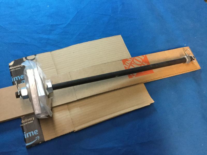

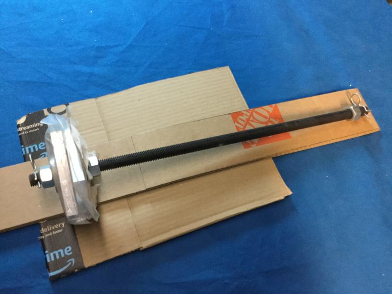

Back in the day I bought a spring compressor from TRF. Went out to get a part number but the bugs ate the label. ISTR they offered a TR3 and a TR6 version, don’t know if it is still offered.F22CDA0C-DE26-4940-ACDA-88AC5CDDB995.jpg
Looks like it is still offered, RFT102. I have yet to use mine so can’t say how effective it is.

I haven't used the Roadster's RFT102 but have used the RFT103 on multiple TR4A/250/6 cars. Easy to use, very safe and effective if a bit tedious just from having to run the nut up the threaded rod to compress the spring for installation or to let the spring relax for removal. These tools are available three ways from them:
RFT102 for TR2 through TR4 ~$70
RFT103 for TR4A through TR6 ~$70
RFT104 has plates from both the RFT102 and RFT103 to cover the range from TR2 to TR6 but only one threaded rod ~$90
I would run from whatever they have Harbor Freight and the like, they don't really fit these cars well (the voice of bad experience having bought a set many years ago and trying to use them) and then once I saw how things were looking, I quickly put some fasteners back at the spring pan/lower arm connection points. The thought of all the pent up energy in that spring coming at out at some unknown angle scared me silly. There's not much upside and plenty of potential injury inducing downside when fiddling with suspension springs and ill fitting, unsafe tools.

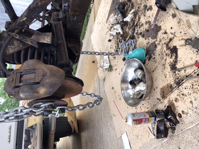

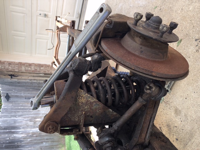

Well it’s another scorcher in North Texas today, 96* with a heat index of 200*, at least it feels that way, dripping hot!! If yer not done by mid morning, it’s gonna have to wait.
I was able to have my son help me haul the Transmission and read differential to the quarter wash for a good hosing off before the heat really kicked in, so there was some progress.
that is all.
C2316D82-C4BF-42F5-A90B-3F755135D6E5.jpeg02923006-0E4A-42BA-A23F-5ACAB075F169.jpegF13AA64B-E065-4370-B541-8EEE2D58C1AD.jpeg158C31F6-608A-4FDE-A51B-5DC491F77247.jpeg
So I’m still having issues with sideways pictures, sorry for the stiff neck.

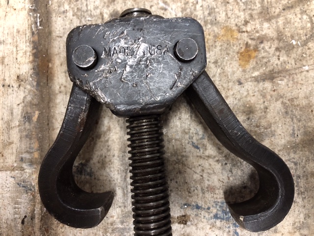

John loaned me his spring compressor and it worked great. Unfortunately there were no manufacturing markings, other than “Made in USA”, so we know it’s NOT from Harbor Freight.
