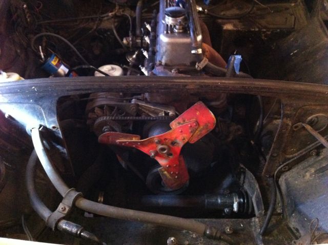

So here's the old setup, with three-bladed fan-of-death ready to shoot a blade through the bonnet.

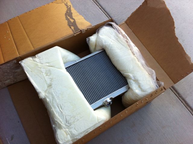

Safely packed radiator, ready to be installed. These folks can weld, let me tell you. You do have to attach the overflow nipple and drain plug -- drain plug needs a bit of teflon tape or similar to seal up.

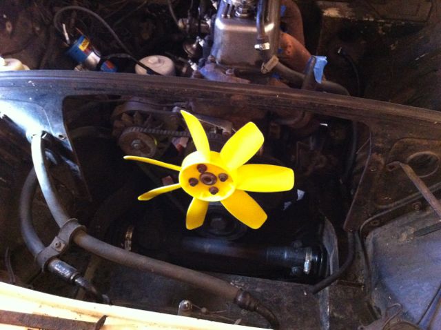

New Moss replacement plastic fan and a new fan belt. Should have added a top timing pointer while I had everything clear, but didn't think about it until I was done.

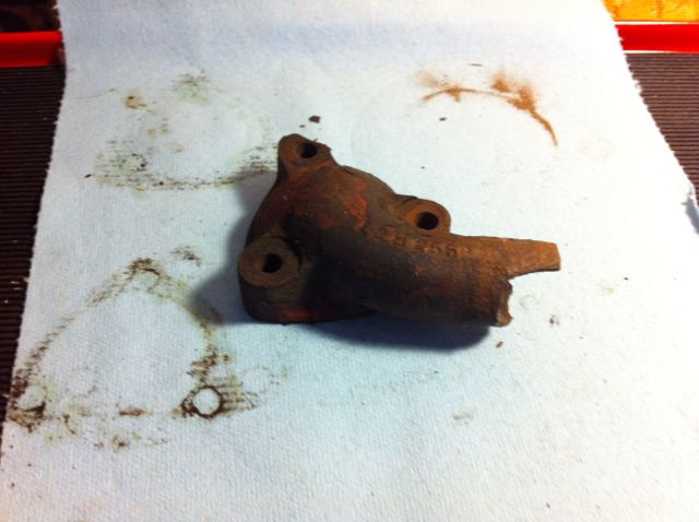

This is what happens when your thermostat housing hasn't been removed in a while, and you use too big of a hammer. Moss sells very nice replacements.

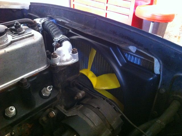

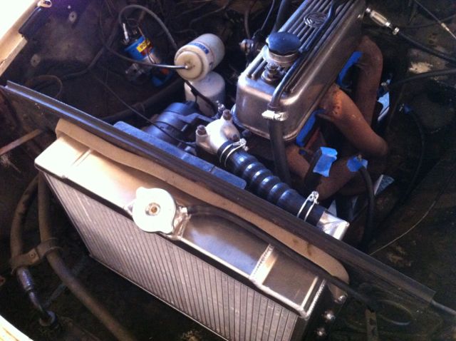

Done, from the engine side. Shroud, fan, radiator in place. Replaced all the hoses and clamps as well. Initially used the original style wire hose clamps, but the were not good at all at clamping. I now have some standard parts-store clamps and they work great.
All in place and ready to go. Completely satisfied with the product, looks great, very well built, works. Not cheap, but for me absolutely worth it.

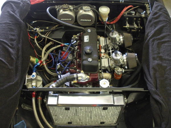

I have the early model version in my race car, and I can attest to their quality, it does a great job, and is very well made.
What year is your car. Their site doesn't show they have anything past the early models?????
My car is a 1970 (November 1970 build). Give them a call, I found them very helpful over the phone.
They have the early version on their site, too. But I didn't find pricing.
