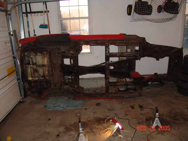

Hey John:
It's possible to replace the outer sills (rockers) without working on the dog legs if you cut them out cleanly at the point where the sill meets the dog leg. Whether that alone is worthwhile is questionable. The outer sill and a parallel piece (the inner sill) make up a box section that serves as a frame rail supporting the car with the aid of the tranny tunnel. Usually the inner sill rots along with the outer sill so you may find once the outer is off you'll need to replace parts of the inner sill. And while your at it the dogs legs will be slightly rotted but they can be purchased also. Then of course that means the floors are probably weak and ...
If the sills are still solid for the most part a quick bodge would be cut out and replace rusted through parts with new sheet metal fabbed up to fit. I'd try to get inside them through an access hole to flush out what will likely be 3 lbs of road grit all packed up inside and holding moisture everytime you go through a puddle. Then seal them off good.
When the gaps between the top of the doors and rear quarters start to close up causing the doors to bind and not close without slamming you'll know that the car is begininning to sag in the middle and the sill job can't be postponed much after that. The job isn't so tough with the engine and tranny removed and the car flipped upside down.

I've noticed a few holes on my inner sills too. They will eventually be replaced as well. Right now my door gaps are just fine. I replaced my sills on my B without a rotissiery. I just braced the doors and flipped it up on it's side. Been there done that. I just want to drive my car a bit first before I tackle the body.

Yes John I see you've been there done that! Rotisseries are great, but a couple old tires without rims allows a guy to roll the vehicle over onto it's side, on the tires, and then you can pick it up, flip it the rest of the way and drop it its top. I had a roll bar on mine and it sat on the roll bar in the back and on two 3 foot 2x6's bolted to the radiator uprights. Ugly, but effective!
