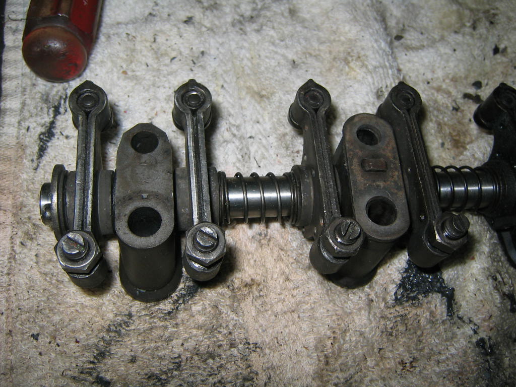

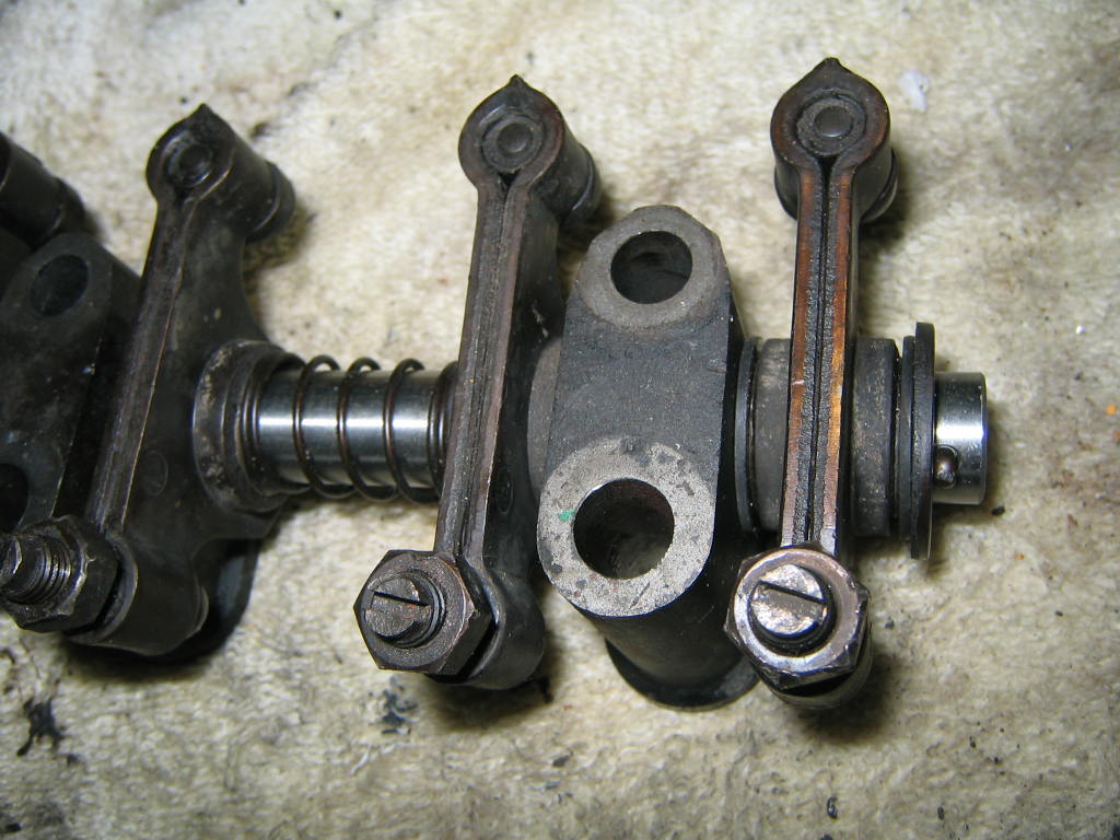

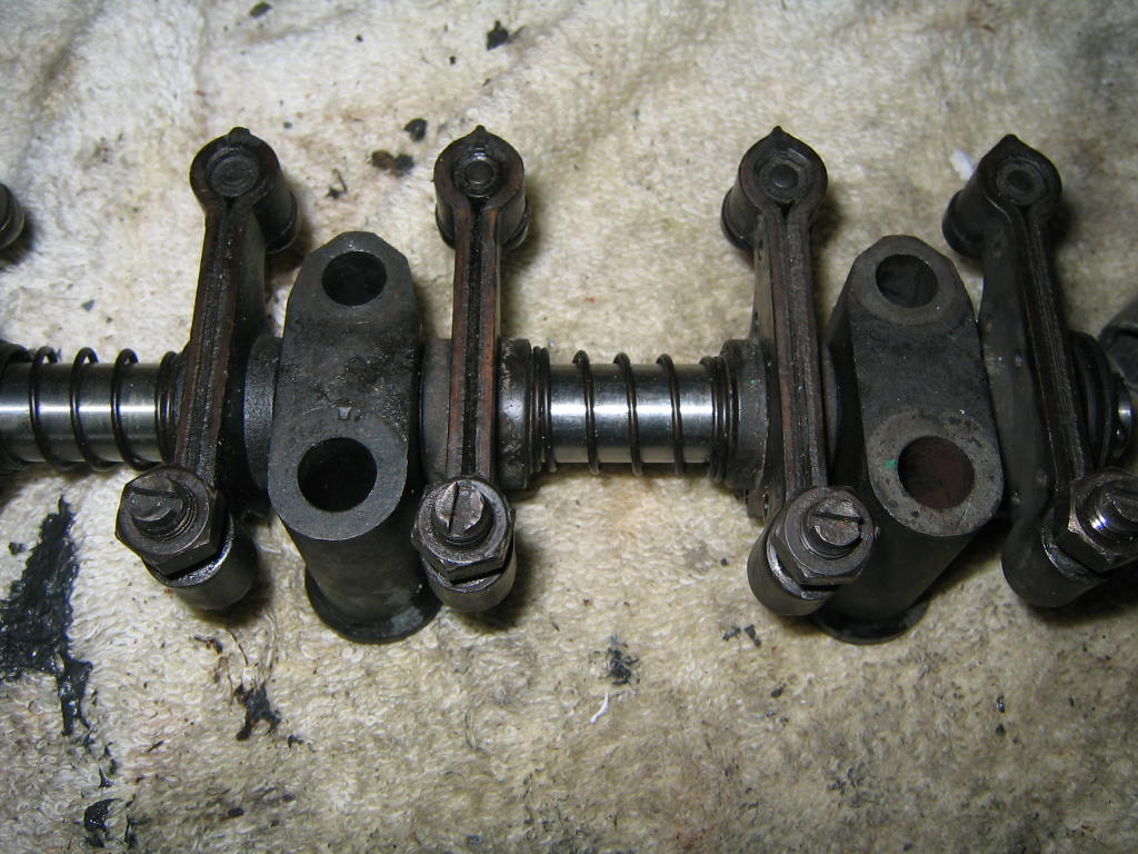

When installing a head that has over sized valves and springs, do I need different rocker arms and or pedestals. Mine don't seem as if they are going to clear. The springs are definitely touching the pedestals and I think will rub the rocker arms???
So I got a hold of the guy who built my head and he said that the factory assembly will work fine. The springs are rubbing the pedestals so badly that I am afraid that I would have to force them into place. This doesn't seem right at all. The rocker arms don't seem that they will clear either. Thoughts? Do I have something in the wrong order?

I was just emailing a pic to a buddy of mine. I also took more of the order in which I have everything in, however, I don't think that is it?? I dunno.

what are those valves/springs from?
what size are the springs, diameter, hieght?
just how much bigger than stock are they?
sure looks to me like they are not going to fit well at all. Now that this thread is rolling i am sure some of the more experienced folks will chime in shortly. ya might try posting a link to this thread in the racing forum.....
mark
To me, the springs look to large in diameter.
I have used isky's without any problems, they visually appear to be 1" in diameter.
Patrick
Springs look huge.
The diameter is 1 1/4'. I am not sure how to measure the spring height, however, I measured from the base of the pedestal = top of the head and got 1 1/8'. ????????????
Those can not be the right springs, they must have gotten mixed up somehow.
I measured the isky ones and they are 1 3/32nds. That is 5/32 smaller in diameter then yours. 5/32 *2 is over a quarter inch (.263158) more in clearance for the rocker assemblies.
Patrick
Man. Obviously mine are wrong. I will wait and see what he says and get back with all of you. Interesting!!! This kind of stuff explains why I end up doing everything at least twice on this car!! ;(
Those are the Comptune style racing oversized valve springs, I recognise them, I sell and use them on the race heads, most of the time with roller rockers. Boz to make them work with your stamped rocker arms, you going to have to modify the rocker arms, this guy should know that, ask me how I know /bcforum/images/%%GRAEMLIN_URL%%/smile.gif You have the clearence them on the underside where they are touching. There is no good reason why those springs were used on a street head, they only come into play with lifts well over .500". I would have went for the little Mini Spare .520 HD valve spring, they are a ton cheaper and will handle lifts up to .520" and are the normal diameter. Your valve spring pockets had to be modified with a special cutter to accomdate those larger spring, I done that many times on a race head.
