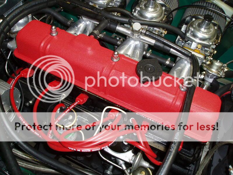

Thanks to Alan (71tr), I took the cast aluminum valve cover off my head and replaced it with a stock, albeit gaudy, cover. Red is the new silver. A little salsa, anyone?
Who said the cast cover tends to quieten the valve train? Taint so. Or maybe my loud exhaust tends to drown out the rocker noise. Actually, my roller rockers were rubbing inside the cast cover, tired of grinding out the inside. Actually, there is more room inside the stock cover, even though it is smaller (and lighter) than the heavy aluminum cover.
Cooked the Wrinkle Paint inside my barbecue pit. (Krylon)

Looking Great Bill!!
Where did you purchase those great red spark plug wires??
I need a set for the Crypt Car!!

I love looking at other people's "stuff"......it always gives me ideas like...I need to get some stainless valve cover nuts like those and dump the nylocs that I'm using. And then there's those plug wires.........if only they came in yellow!
But.....you did get Paul's approval before going with the red valve cover I hope! After all he has cornered the market on the use of red in an engine bay. :angel:

I like those acorn nuts, too. Reminds me of the ones on the old Jag's valve covers. Good thing about them is that it's harder to overtighten them and dimple the original valve covers. You know how easy that is to do.
Right. A thought I had was whether you could actually tighten them
enough; but, I doubt they would be there if you couldn't. Not very
likely Bill would put them there if they caused a leak.

I sincerely hope that the top of the Optima battery is red too!

The wires are Taylor. High quality wire set that you cut to length. I believe Pegasus has them.

For any of you curious about how to get a good finish on a part with crinkle paint, I have become somewhat of an "expert" on the stuff. First, buy only Krylon Wrinkle Paint, from most auto parts stores. I found mine at O'Reilly's auto parts. I have found Krylon to always be a superior quality rattle can paint. (I used Krylon Semi-Flat Black on my rear Kamm-back and windshield frame without ever having it show age or peeling.) Anyway, clean the part very, very well. I used a friend's media-blast cabinet to strip the valve cover. I pre-heated my gas barbecue pit to "hot" and then sprayed the cover with <span style="text-decoration: underline">one</span> uniform coating of the paint. Then immediately transferred the cover to sit atop a brick inside the hot barbecue pit. Oh, and I turned the flame off first. That stuff is pretty flammable! Within moments, the paint crinkled perfectly. You can use your wife's oven but not sure if the odor would put you in the dog house for a while. Let the item cool (not very long, trust me) and, voila!, a really nice, tough crinkle finish. The secret is to not over-apply the paint. The instructions suggest several coats and fairly thick. Wrong! One uniform coat is all you need. Too much paint and, believe me, the stuff runs. Stop if it does and strip the paint and start over. RUNS DON'T WORK. IT WON'T SMOOTH OUT. Ask me how I know this, three cans later. I used a very, very corrosive paint stripper to take the first two tries off. Worked quickly but unnecessary if you follow my "expert" instructions. There. My tip of the day.
