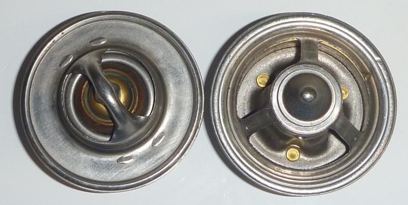

I bought the 160 degree sleeved thermostat from BCS and moved the sleeve to a 180 degree version of the same thermostat purchased from Summit:

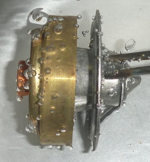

open at 180

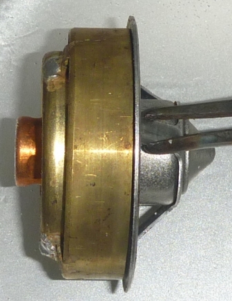

when open, sleeve blocks bypass port
180 label and where I soldered the BCS blocking ring in place. Used a soldering gun because a torch would open the thermostat immediately and needed the ring to seat against the flange without preventing thermostat's full closure.

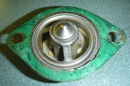

used 2 Moss green gaskets. The lower one was opened up to match the diameter of the thermostat. Upper one, standard opening.

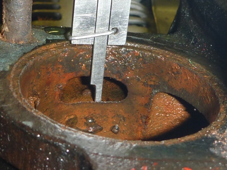

The Moss sleeve tubing is 1-7/8" OD, with the flange 2-1/8" OD. The width of the blanking panel is 1.2"
You could get by with 2" OD tubing and just cut a slice out of it to fit in the t-stat opening. The problem would be getting the flange smooth enough to seal.
At $15.95, the Moss sleeve is cost-effective compared to building it yourself. The fail-open t-stat is similarly priced.
note sizes of openings
