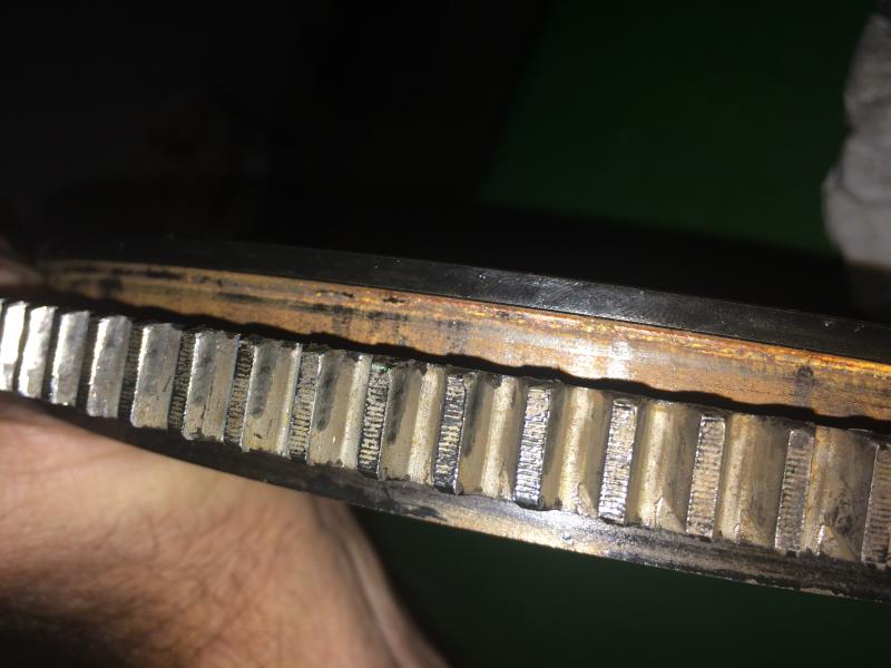

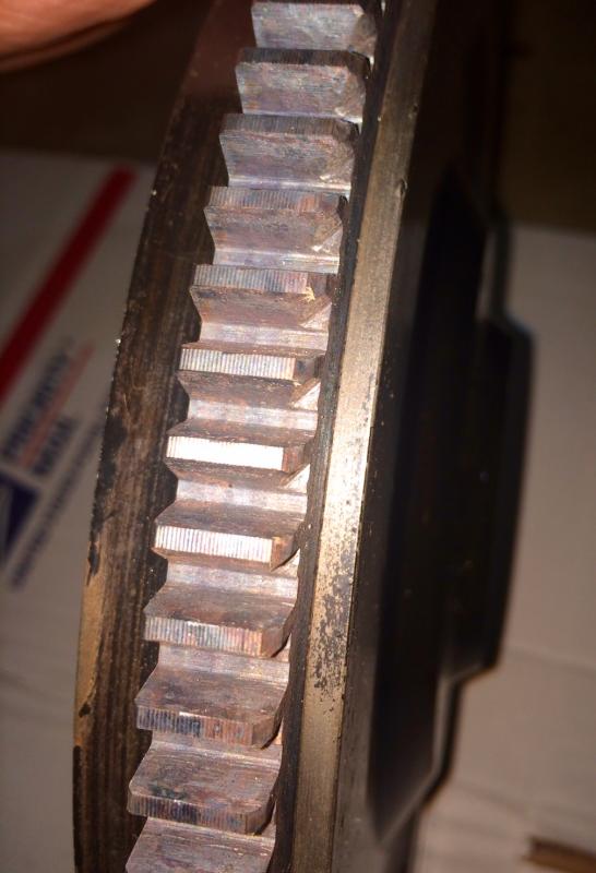

Been there, done that doc. My ring gear moved about an inch from the shoulder of the flywheel. I was left with no choice but to pull the trans and flywheel and install a new ring gear. What a PITA for a $30 ring gear. With that said, I have not had any problems since installing the new one about 3.5 years ago. Get it done!
Ring gear moved away from shoulder
New ring gear installed

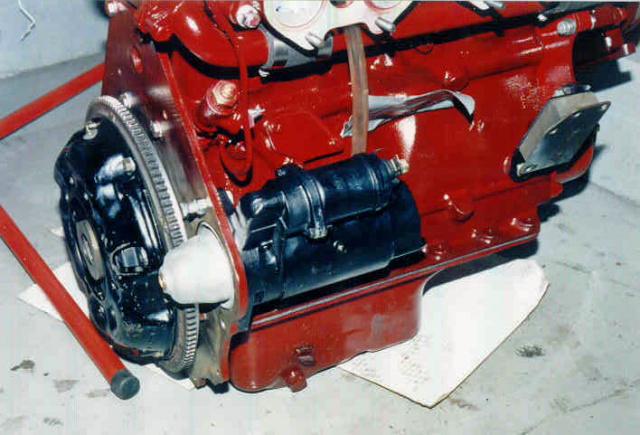

You might want to consider using a pre-engaged starter out of a post 1968 MGB. I know that they can be fitted to the 5 main rear engine plate for 1965-1968 18GB cars but haven't personally checked to see if they match the 3 main rear plate but believe that they will. Just a happy coincidence that the spacing is correct. They slide inti the ring gear before twisting so no more crushed teeth.
Another cheap way around it is to remove the flywheel, turn one crank stud over and refit. The engines stop in only two positions so tat would present a 'fresh' set of teeth for the starter to use.

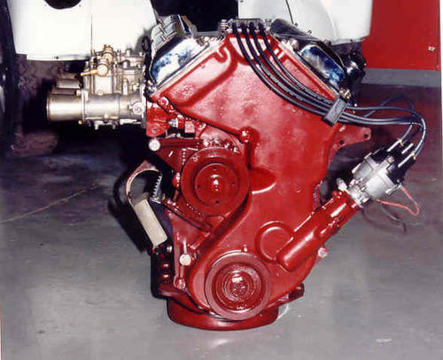

Here is a late starter fitted to my MGB Twin Cam race engine.
Thanks for the info, Bill! This is a five-main 'transplant' so that could forestall the need to pull it out. Surprised I'd never tried that, considering all the MGB's we've had through the shop.

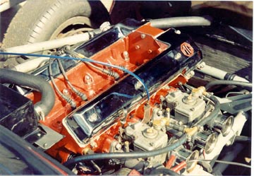

Looking at that photo, I'm curious! I see part of the intake, looks like it's meant to mount a pair of DCOE Webers? And what does the distributor drive from? One of the cams, I surmise. Would like to see more!
That is the side of my 1950 cc 5 main Twin Cam race engine (I created it back around 1980). Last pic is when I was developing it and put it in my TVR Grantura Mk 3 race car as it was easier to get at things.

That's durn'd impressive! Were you able to source the head or did you have to fabricate the inlet runners? Extensive work done to be sure. Did you have to cast the front chain cover? I don't recognize it.
I've a spare flywheel with a good gear and a new ring gear to replace the bad one on hand. Just need a cleared out garage!
Bill said:
The head and front timing assembly comes right off a Twin Cam engine. The trick was mating it all together.
