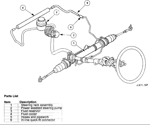

Cheers TOC - I have reached out to almost all of the links you provided and now am waiting to hear back. I am really hoping to get the conversion done here stateside because I have the next three months off before leaving. I'm imagining my biggest expense is finding a RH steering rack and box due to the complicated PAS setup. It would be wonderful if I could just flip it around but that would be fanciful dreaming because of the LH biased geometry! I'd need to re-route the fluid lines for the PAS and break master cylinder (once moved). The next big expense is going to be finding a full RH dash because the only things I can re-use are the steering wheel & column, glove compartment, instrument panel and clock panel. I am going to have to figure out the ducting and harnesses as well as the pedals & linkage plus relocate the park break. The driver door controls will be much easier once the dash is out but I am sure they will put up a fight.

That's why I said rack and dash.
If you can get all, including P/S lines and hoses along with the rack, and you may need the instrument cluster, if yours tapers off to the left.
If it's perfectly mirrored down the centre, great!
You will need probably a different throttle cable, gauge wire extensions (depending on where the loom enters), speedo cable (if not electronic), maybe a floor shift lever at some point IF it has a park release button on the left side.
Operating said release with your pinkie is not on.
I know on a MK2, it isn't only swaping out dash pieces, column, box, throttle linkage, brake lines, but flopping the e-brake over AND....every gauge has to come out and swapped to the opposite position.
