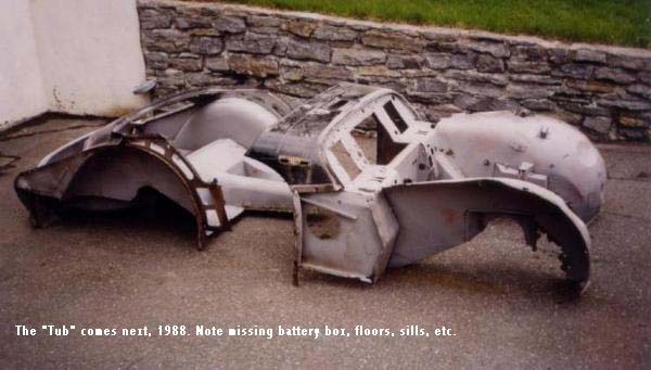

The floor pans I bought in 1988 in England for my early 1958 TR3A restoration came with the front end of the floor pans flat - towards the front. But my early TR3A came with a turned up lip about 3/4", so I had to do that when I was welding it in.
For the late TR3A I did, the floor pans fit at the front because these later TR3As have a flat ledge which extends flat out towards the front which collects dirt etc. and leads to rusting and rotting rather quickly.
The rear end of the floor pans for my early TR3A had to have an overlap fit with the little flat bit of the original floor at the cross seam.

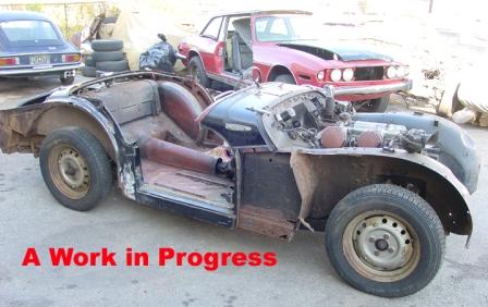

Don-
I think I had you beat on your first picture, but that second one is going to be tough!
Here's my 59 with a little less adornment. Sills look really good which is a new experience for me!
Randy
