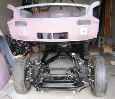

Any one have any sketches or pictures of body support frames? How did you lift the body? Questions, questions....
I utilized a simple inexpensive chain hoist from Harbor Freight. The body does not weigh that much (scary!)
I supported it with a lifting strap placed under the body.
You can see the straps if you look close at the top of the photo.
Also, I'll get you a sketch of the frame.
<span style="font-style: italic">edit: oh yeah.... make sure the location where you mount the chain hoist can support the weight. You don't want to bring your ceiling down!</span>
