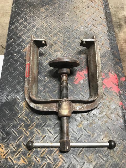

I just used a floor jack to do this, then put the bolt back so I could use the jack to unload the spring pan and remove the front spring. No long bolts needed to do it, but it would've been easier with the correct tool.
