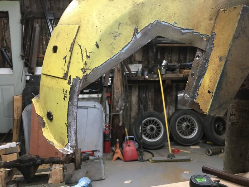

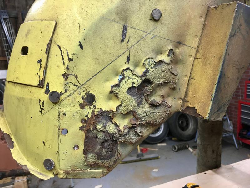

I have gone thru this repair and is not an easy repair, but my car was in bad shape.This shows the damage and the cut lines to remove the damage.

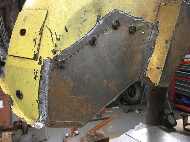

IMG_0367.jpgdamage removed IMG_0368.jpgpatch panel fitted ready to tack

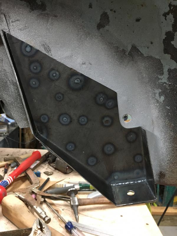

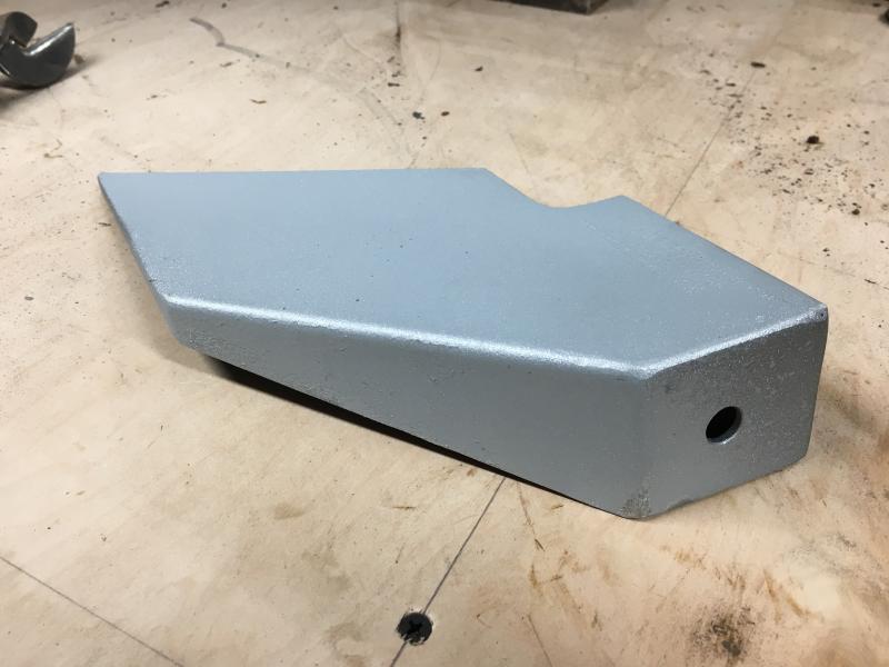

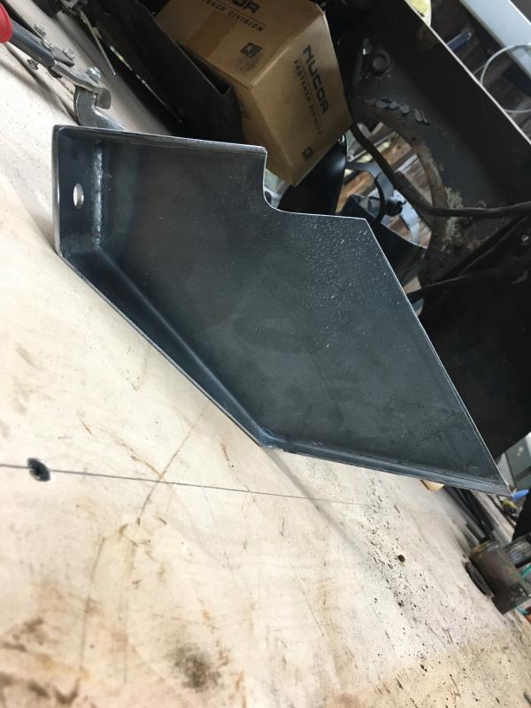

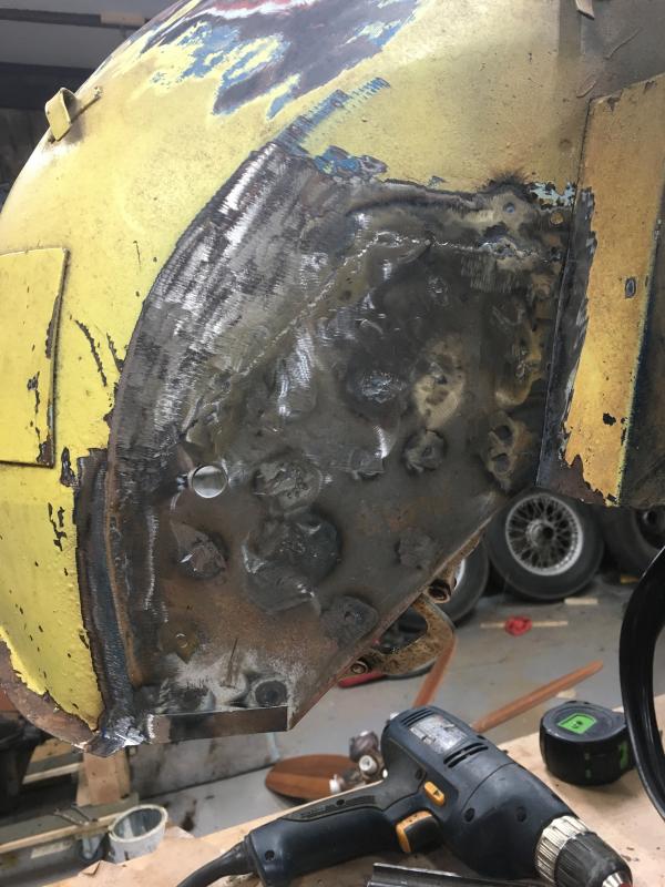

IMG_0369.jpgIMG_0381.jpgIMG_0387.jpgbody mount fabricatedIMG_0388.jpgzink primer where the body mount mates to the inner wing. I made the bottom of the body mount stronger using 11 gauge where the body mount bolts to the frame.
IMG_0383.jpgbody mount plug welded to the inner wing welds

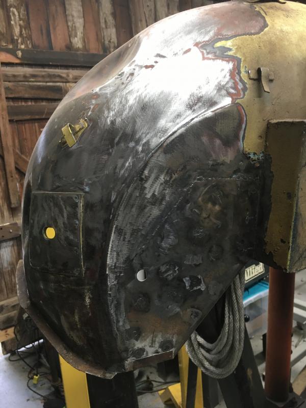

IMG_0381.jpgIMG_0595.jpgwelds ground, hammer and dollied and body filed. driver side same as above.
Hope yours is not this bad, Good luck, Frank

Nice photos Frank. That’s exactly what I had to contend with and what I was referring to.
