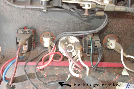

As an added note, I would take a photo of how every component is wired. All those connectors look the same when they’re neck’d. Also make note if there are wire color changes at any bullet connectors. Exhibit A:
