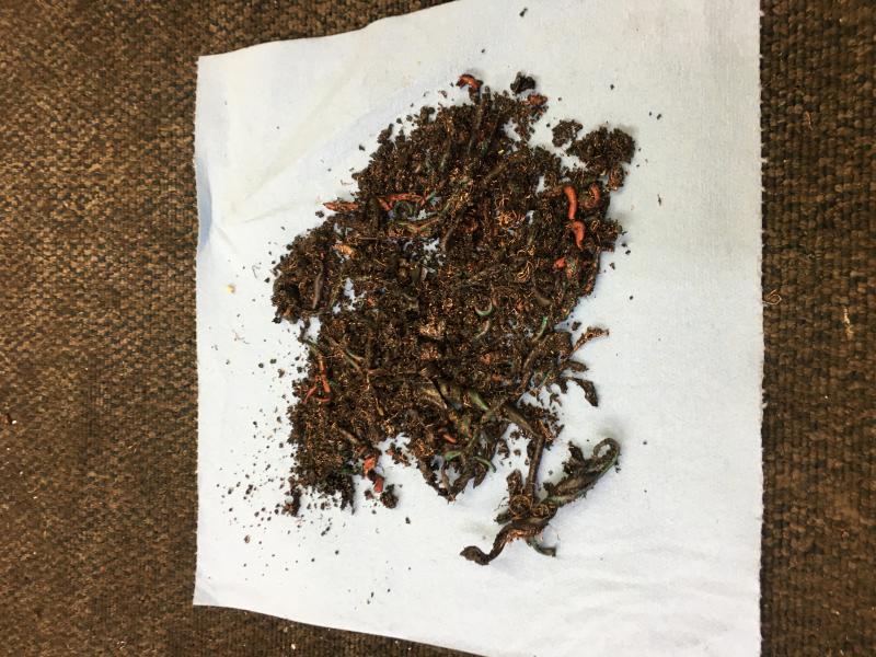

Well it was not a very elegant solution, but I welded a 3/32" extension bit to a length of 3/32" piano hinge material I had, chucked in the drill and just kept drilling into the wiring. I worked from both ends and for the first 45 minutes I really didn't think I was getting anywhere. Then chunks of insulation and copper started coming out (and wads of electrical tape). I finally got all the wiring out. I'll make a butterfly to clean the bore up completely tomorrow, but I think I saved it!

Wow - what a pain, and what a mess, but you figured it out.
How on earth would anyone accomplish the task without the destruction.
Congratulations - you're a better man than me!
Tom M.
So you drilled it out...interesting idea. I wound up chucking the tube and making a new one because the wires were so stuck.
