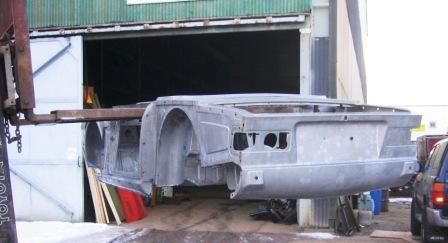

When we restored the TR250,in 1983, we found that the PO had sprayed the entire body shell with undercoating - inside and out. I used gasoline and a scrapper, and maybe a years worth of old newspapers. Definitely an outdoor project - and I don't smoke! It did work. The tar gets very soft, but I would never do it again. :nonod:
I finally gave-up trying to strip it by hand and sent the whole body shell out for chemical stripping. It was FAST, and it came back CLEAN. Yes, it was expensive but in the end for me it was the best way to go.
And YES, you do have to seal / coat the areas that are hard to get to once it is dipped; but it can be done.

This is how I removed mine. BCF
I just had a car blsated, two weeks or so ago, and all the undercoating was GONE when it came back.

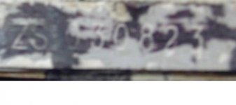

propane torch and scraper seems to be doing a pretty good job. Get some of the hard stuff loose and next thing I know I've got a big sheet of it coming off. The blaster told me that if I get the majority of it off the blaster will take the little stuff off, guess we'll find out. Found an interesting tag in the LH rear wheel well while scraping the undercoating off. The numbers on it don't seem to jive with any other numbers on the car. Would this have been the body number at the plant the body was made at? Tag reads ZS 030823.

Funny what you sometimes find on these cars. My wifes MGB when I restored it, still had the original paint under the tail lights. There was a pair of initials put there with a yellowish paint. I was told that sometimes the painters would put their initials there just for the fun of it. How true this is, is anybodys guess. They were taken off when the body was stripped, sorry to say. PJ
My TR4A body had the same thing in the same wheel well. It was a replacement inner body shell which did not come with any tags so I had nothing to compare that number to. Unfortunately, I don't recall looking for the number on the original body shell to see if it matched the body number on the tag.
