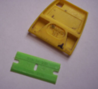

I would suggest an over-lamination of clear vinyl (as used by sign shops)trimmed to the edges of the sticker to hold it together, and the use of a plastic razor (also found in sign-supply sources)to gently lift a corner without any damage to the underlying paint, and moderate heat to soften the adhesive and ease removal by gently lifting!
