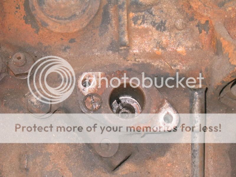

I pulled an angled tube and screen out. There sill seems to be a 2" or so thick piece of aluminum in the block that I am not sure how to get out. Is that in my way?
You can see a pic of it in my "New tools" thread.
Vince, you need to remove the entire oil pump body. You have it still in place in the photos. That'd be a large diameter (about 1"- IIRC) aluminum piece.

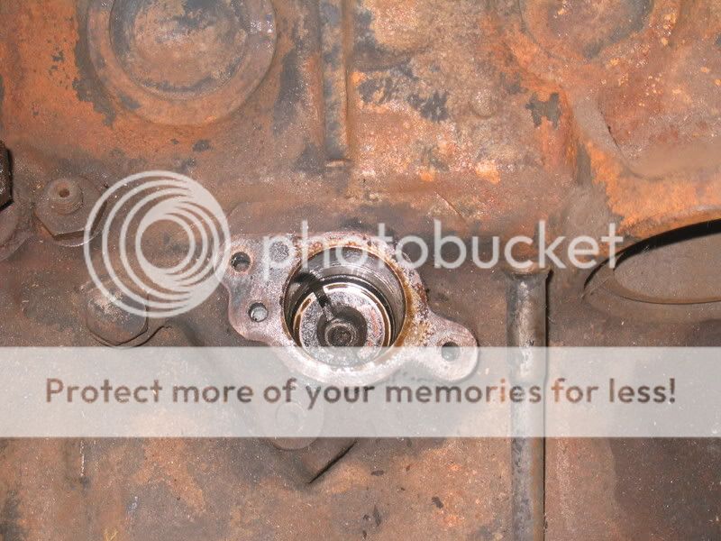

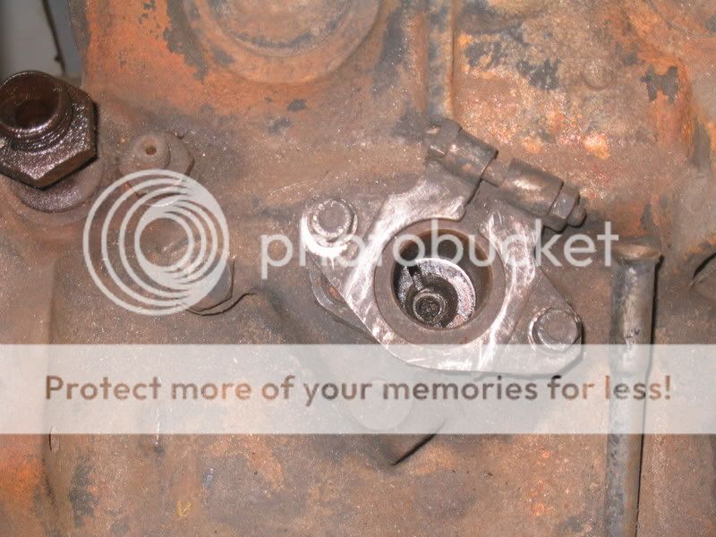

err what's a tappet. JOKE. yes they are out. The oil pump body feels pretty solid but I guess the studs are tight enough that it does not wiggle at all. I'll go takeout the studs and see what that does.
Drive dog? donde?

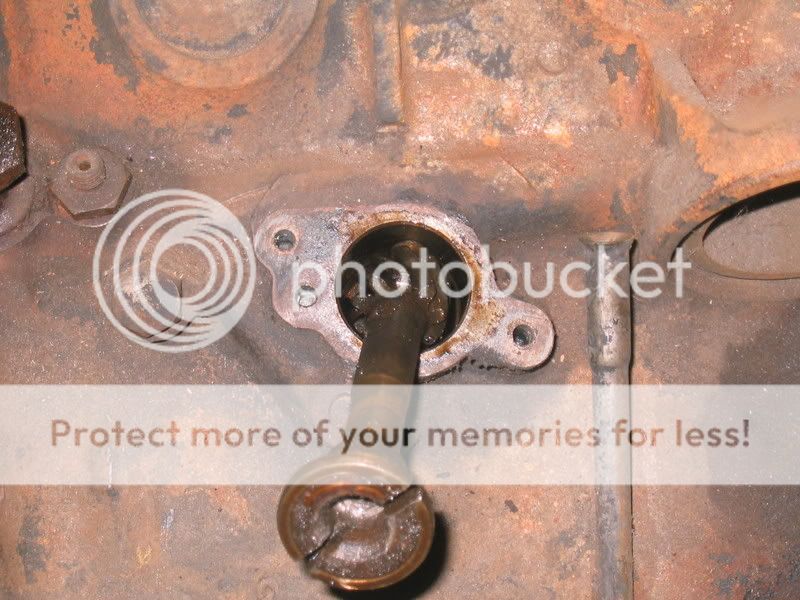

The thingie you can see when looking down the hole where the dizzy mounts... small diameter hole inna middle. Thread a long stud from head or suchlike into it and draw it out. It has a helical gear at the base wot is driven by same onna cam.
vping said:
Drive dog? donde?
Vince-

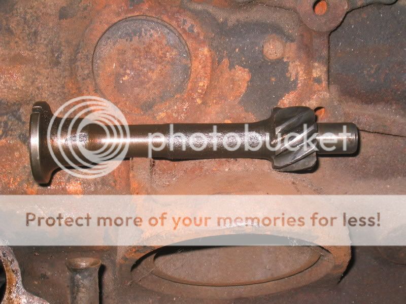

A "drive dog" is the thingy that connects the cam to the dizzy. It's tubular, about 5in long with a gear on one end and a slot on the other. It is made of unobtanium and so is the dizzy housing. As Doc said, thread a bolt into the center of it then twist it up and out.
The cam just slides right out, but be careful you dont nick the cam bearings when you remove it. It's really easy to bump into them with the lobes. If you are replacing the cam bearings, then don't worry about it.
