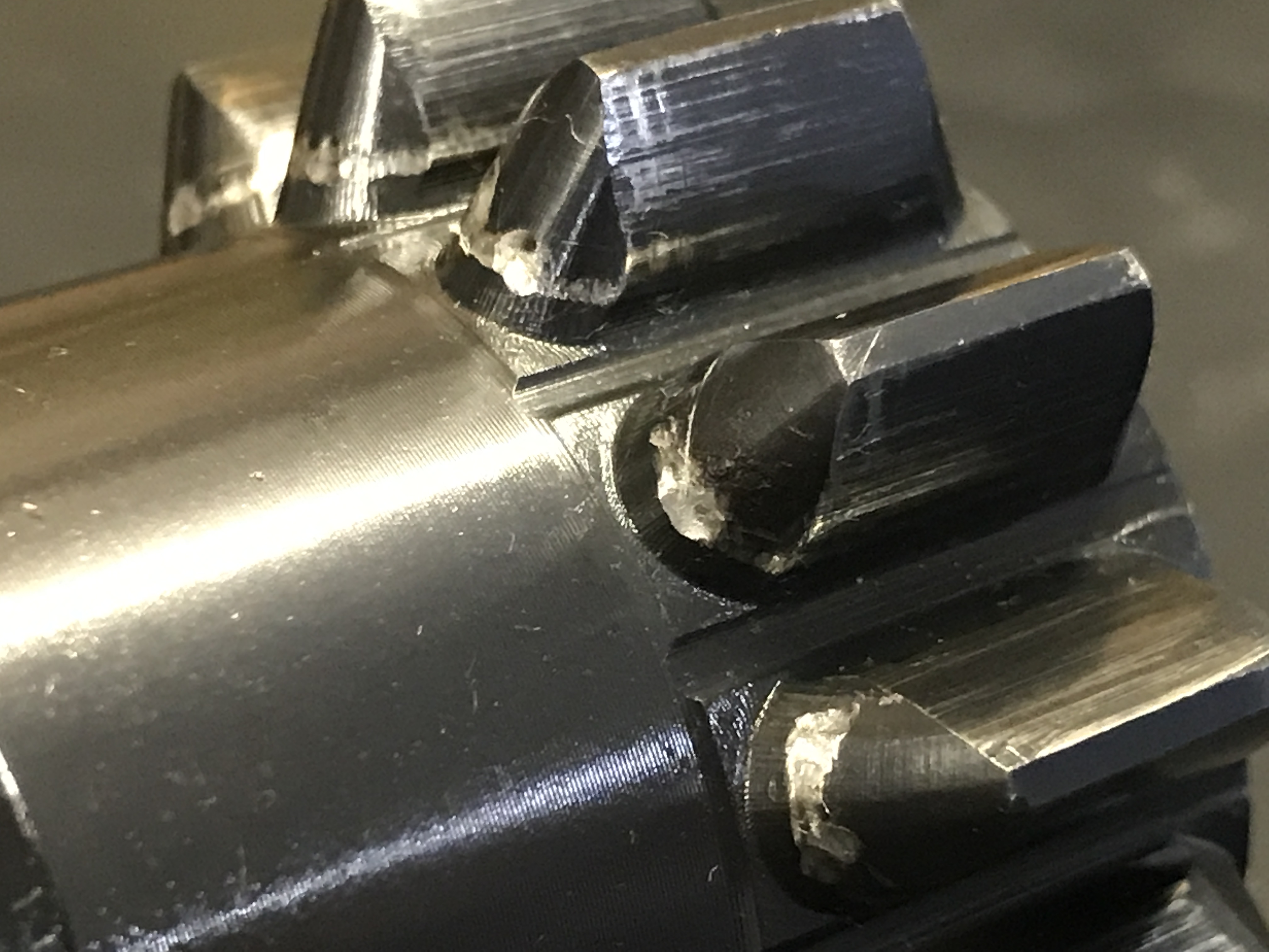

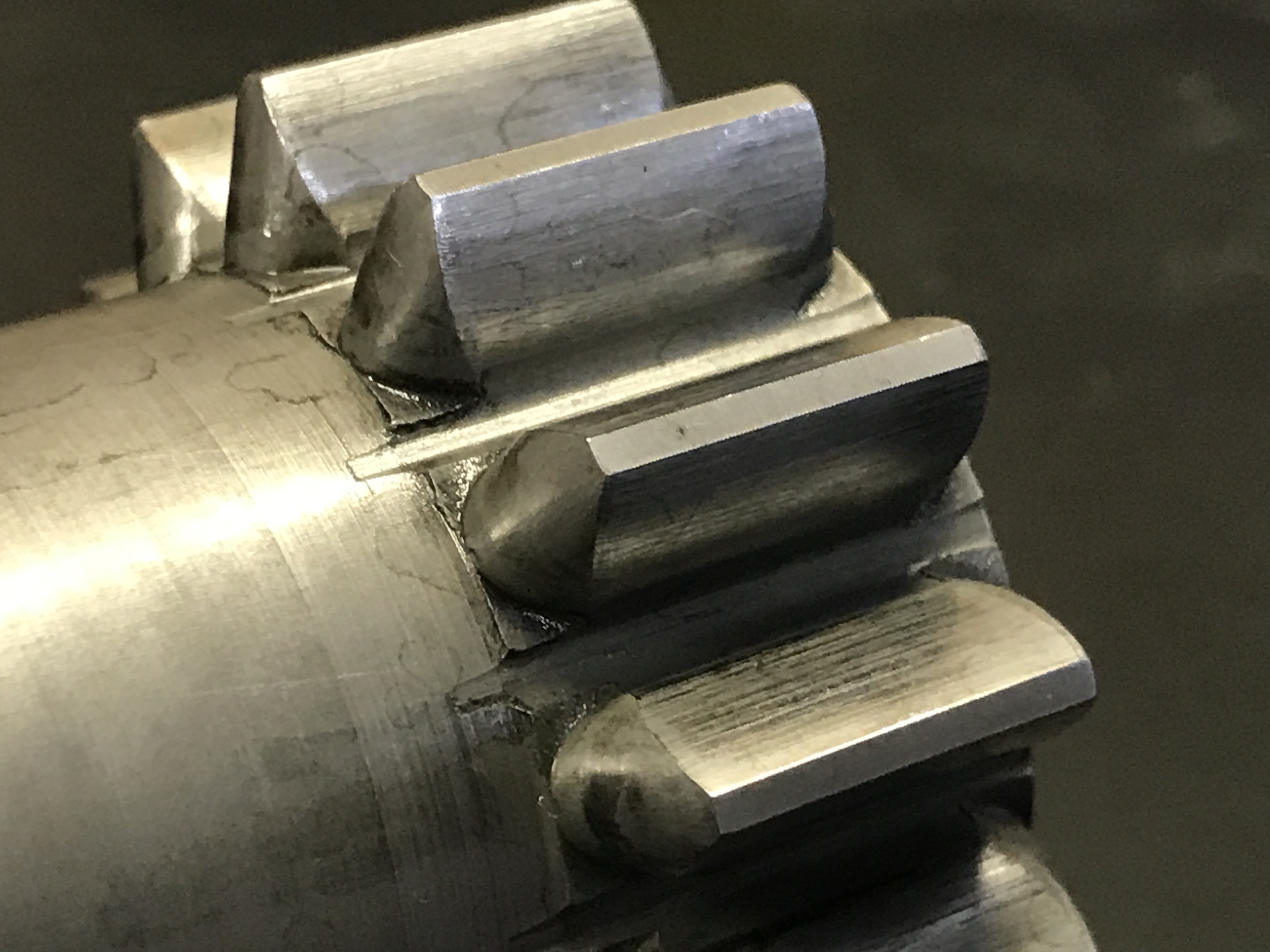

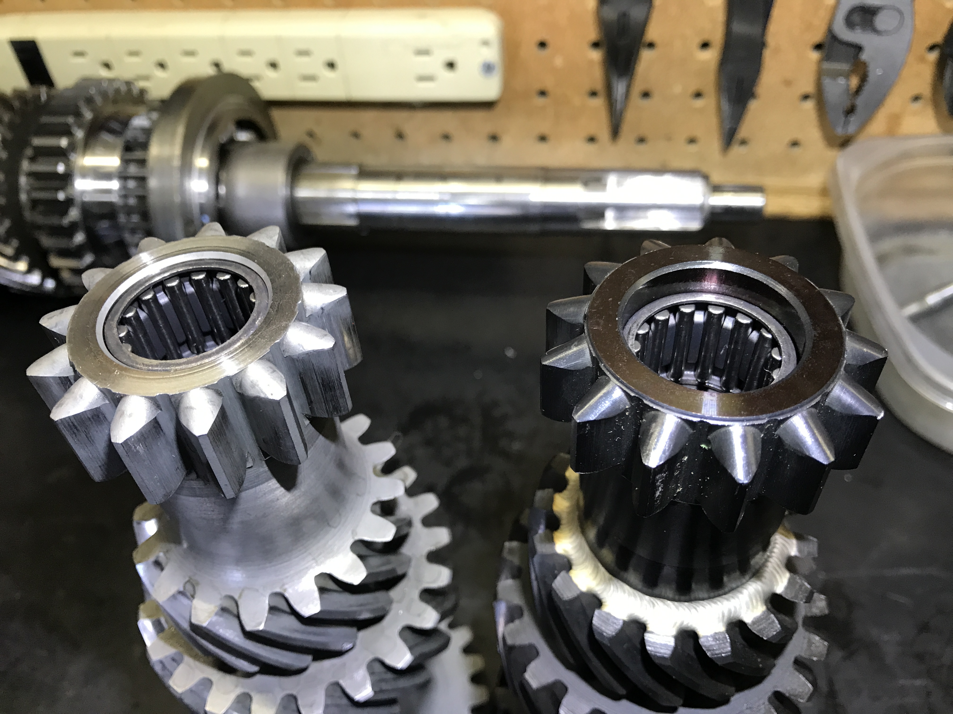

I've installed a new one piece reproduction from AHSpares (photo of the one with the spacer) 4 times (about 10 total miles on it) makes noise in 2nd gear. However there's been no wear to any of the gears, not even 1st.
I just installed a welded 1st gear unit. After about 1 mile, no signs of wear on 4,3,2. 1st shows wear, chipping. I've made sure to baby it when going into 1st and reverse. Haven't heard any grinding noise.
1st photo, AHS.
2nd AHS close up of 1st. (10 miles)
3rd welded next to AHS. (close up, dust shown on 1st gear sides, not damaged)
4th welded close up of 1st, (1 mile, chipping already.

I don't know anything about the specifics of heat treating, like degrees of hardness. There are no doubt engineering standards for degrees of hardness. Resistance to abrasion and resistance to shear are 2 different things. I am pretty sure you can't heat treat the welded repair. You have no idea of the composition of the weld metal versus the original metal.
If you have a welded gear in your transmission that is being driven tooth by tooth, you will soon have damage everywhere from the chips and chunks, no matter how much babying you think you are doing.
My BJ8 is living proof that these welded 1st gears do not last. I was obviously not aware it was welded on when I bought the car in 2001. The car was not driven many miles since its restoration a few years prior. It lasted about 10 years before the weld broke free. No idea about the heat treatment. I suppose it was fortunate there were no bits if any that did any damage since I was stopped at low engine speed when it gave way. New laygear installed and all has been good since.
I looked back on the invoice from 10 years ago and the work done on it. The part was an AEC3649R reman laygear. The cost was $425 and not sure where it came from but I recall the shop searched for a long time before they found this one!
