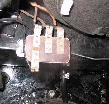

The overdive relay on my 1958 TR3A has the same lettering on the terminals. A relay is a relay and could be used for the horns as well. I heard that the recent relays are quite expensive. Mine is the original that came with my car.
