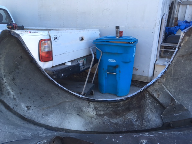

I am getting my car ready for paint (taking much longer than anticipated) and part of the process is welding reinforcement rod in the arches.
Attached are some pics of the process. Rod stock formed using pipe bender tool and follow up on vise by hand ultimately welded in place with vise grips and clamps. The fender in pic needs some work as it was hit years ago but is coming into shape.
Lots of hours spent on project which as we all are aware are precious to find.

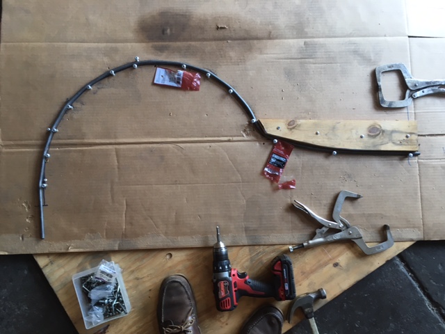

Made a forming jig after tracing the arch on cardboard. Made the job so much easier, able to form the 3/8" rod stock with minor effort.
The fit was close and tight which allowed for much easier welding on this side.

While reinforcing the wheel arch for a front tilt setup is a good idea, it really is not the main factor for the fractures; usually, they already exist. Most cars with fractured wheel arches are so due to the stress fatigue caused by lifting the very heavy nose from the front over the years. I'm quite sure there is actually more weight on the forward side of the wheel arch the the rear side. Next time you have one off, try lifting the front or rear independently, and you'll see what I mean. Hinging from the front probably puts less stress on the apex of the arch than the factory hinge, but with sheet metal this old and a pending paint job, why not take the opportunity to prevent possible damage in the future.

So what was the trick to getting it to fit the curve. Start clamping and then more clamps. I'm trying to imagine doing this without introducing a kink in the metal. Thanks. An intermediate Picture along the way would be nice to show how the magic happened. Is heat the key?
