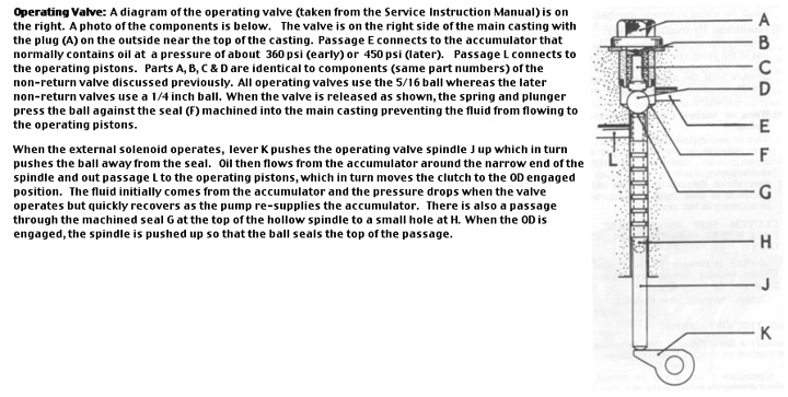

Heavier oil "may" solve the problem for a while.
The problem would seem to be that the pump/accumulator is not holding enough pressure when the oil gets thin. Looking at the attached drawing - & in order of increasing difficulty to fix:
1- Ball "D" is not completely sealing against seat "G" on the end of the spindle when the OD is operated.
2- Ball "D" is not completely sealing against seat "F" when the OD is not operated. This could prevent the accumulator from reaching it's full pressure.
3- The accumulator seal rings are leaking.
4- The oil pump may not be sealing or pumping correctly.
These four items can be fixed without removing the OD. The next item would require removal.
5- The operating piston's seal rings may be leaking.
Serious diagnostics will require a good pressure gage & someone with deeper knowledge.
I hope it's something relatively easy.
D

Thanks Dave,
I think I have already eliminated 1 and 2 .
It is probably 3 or 4 .
But only fails after driving the car for a long time on a hot day. I am hoping it will be better when I switch over to 60w .
Also, it may not happen as easy with the new radiator core keeping the engine block temps. down. We'll see.
