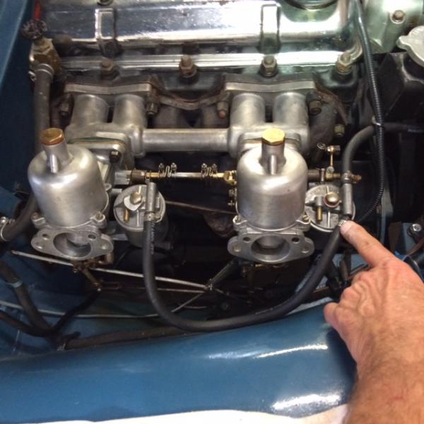

1956 TR3. I purchased a set of SU H6 carbs from a forum member months ago. They were rebuilt by a very reputable carb guru, but sat on the shelf for a couple of years. Today is Saturday, so I couldn't call the rebuilder and ask any questions. I put them on today and can't get the car to start. I am only getting fuel to the front carb. My old ones had banjo fittings, the new ones just have tubes in and out of the top of the bowls (see picture).
Thanks in advance for your help!

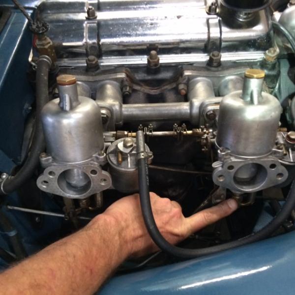

Question, does the front carb have to fill the float chamber before fuel is routed to the rear carb (see Pic). The inlet and outlet appear to be a straight pass through.
I did manage to get enough fuel in the front carb to have a leak. It is dripping out the bottom of the center of the jet spring, clamping screw, and actuating lever.
Question - how do I diagnose this and fix I'm guess old dry seal?)? Is there anything to tighten.

IMO the only cure for that leak is to replace the seal. You might get it to seal temporarily by soaking the cork in oil, but you'll have to disassemble to do that anyway, might as well change the seal. Moss sells some nitrile O-ring seals that last much better (in my experience) than the original cork ones do.
Don't be tempted to stretch the spring inside to put more force on the seal. It will mess up the choke action.
Edit: The front carb does mostly fill up before the rear one. Not sure why, must just be less resistance to the flow.
Hello Randall, I have had issues with a leaking cork carb gasket from time to time. Maybe I'm not looking in the right place on the Moss site, but the carb diagram only shows cork #(97) ? Maybe I'm missing something ? I would like to give the nitrile gaskets a shot if I can find them.
It's actually just a standard size O-ring. I forget the size offhand, but I found them in my HF O-ring assortment.
Moss P/N is 365-420 "O-RING (leak-free replacement for #295-200)"
