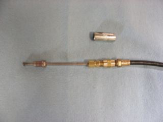

Here's the setup I use. From left to right:
1/2 of a 3/16" brake line and fitting with bubble flare
3/16" compression fitting to 1/4" NPT adapter coupling
1/4" X 1/4" NPT coupling
Hose on grease gun with 1/4" NPT male fitting.
The silver cylinder in the top of the photo is the adapter that has to be removed from the grease gun
This has never failed me. One hint: If you have synthetic grease in your gun, be prepared for a miserable clean-up job. Most solvents won't touch it.
Marv J
