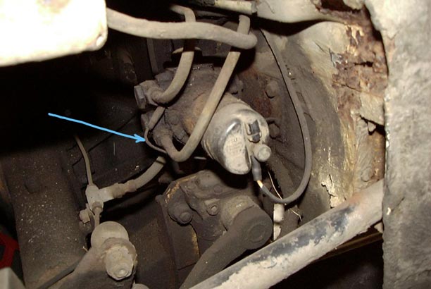

germanmichel said:
...I know that the ground come only over the support not over a wire connection...
Hmmmm, I have a '67 BJ8, so things may be different. I do have a seperate ground wire. See the blue arrow in the photo.

The later cars moved the fuel pump to the other side of the car on the heel board. My photo earlier in this thread shows the location.
