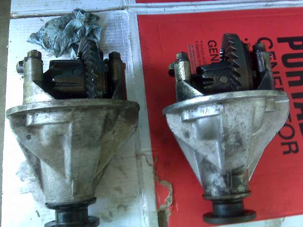

I am not sure if the numbers are there on all the rearend housings and I would not trust thos numbers if it was. Best way is to turn the drive shaft yoke and count how many yoke turns it takes to make one wheel revolution. The gear sets are far enough apart to tell them this way pretty easy.

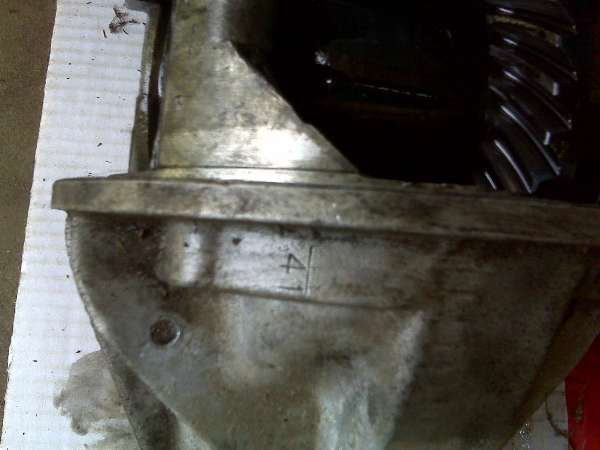

OK, I turned the shaft flange 3 3/4 turns to turn the wheel one turn so would that be a 3.7 rearend. also the numbers on it are ATA7241 11-41 if anyone can decipher that for me I would really be grateful thanks.
pics of a 3.7 and the same next to a 4.22.

41/11 would be 3.7. Assuming the gears are original to the housing.
Yep that is a 3.7 for sure. Looks like you have an unmolested 3.7 diff.
