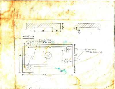

PS: for anyone doing work on the quarter elliptics, years ago I had made up my own design (see attachment) of spring plate that eliminated the U-bolt set-up in favour of 4 grade-8 straight bolts. Much easier to remove/install!!! /bcforum/images/%%GRAEMLIN_URL%%/thumbsup.gif

That was why I drew up the above and had the machined pieces made!! /bcforum/images/%%GRAEMLIN_URL%%/thumbsup.gif
