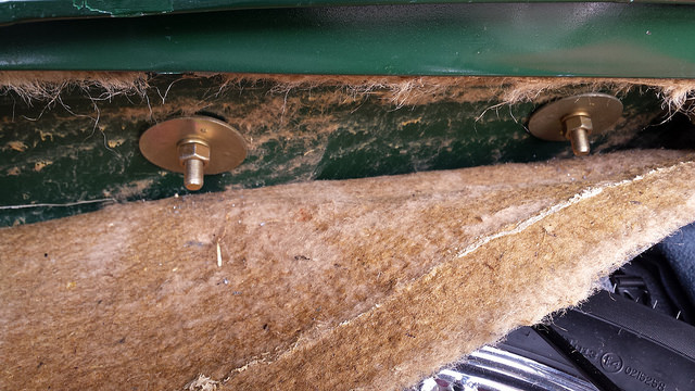

Hi Bill -
I installed factory style rear seat belts in my '65 BJ8 about 20 years ago to accommodate my 7-year-old son and 2-year-old daughter at the time. I modified a child's car carrier so it would fit tight in place to keep our littlest secure. The four of use took many long trips to the beach together and I still have the big bag of sand toys which you could only place in the boot one direct. Many great family memories, including the Healey Rendezous at Lake Tahoe in 2003. Here's a few pictures of the belts, I ran the straps under the rear seat back rest for a clean look.
Thanks Dougie. That does look clean. I assume you had to remove the seat-back/parcel shelf assembly to install them. It looks like you had to drill the holes pretty high up the rear firewall/bulkhead. Thus the belts were routed down the bulkhead, then under the seat-back, then "up" around the waists of your rear seat passengers. It seems to me that the passengers' body movements in the car would be pulling up on the seat-back assembly. Did the use of the belts ever cause any problems with your seat back assembly? Were you not concerned that in an accident the force of the passengers against the belts would lift or break the wooden seat-back assembly and allow the passengers to fly too far forward? Sorry for all the questions, but I like what you did and would like to do something similar.
