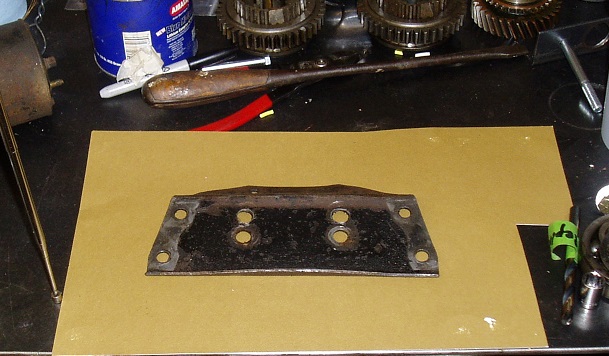

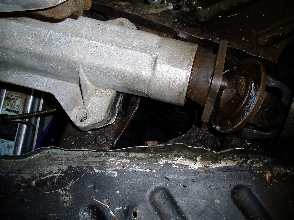

The problem is that rear mounting flanges on the replacement gearbox fall 1/2 inch forward of the rear mount. Is there that much flex in the mounts? The rear mount was new a couple of years ago. Everything lined up easily with the OD gearbox. The front mounts appear good but age unknown. I cannot lever it back with a punch as seems quite happy where it is. I've measured the tail sections on both boxes and they are as close as I can get with a tape; certainly not 1/2 inch off. What am I missing?
