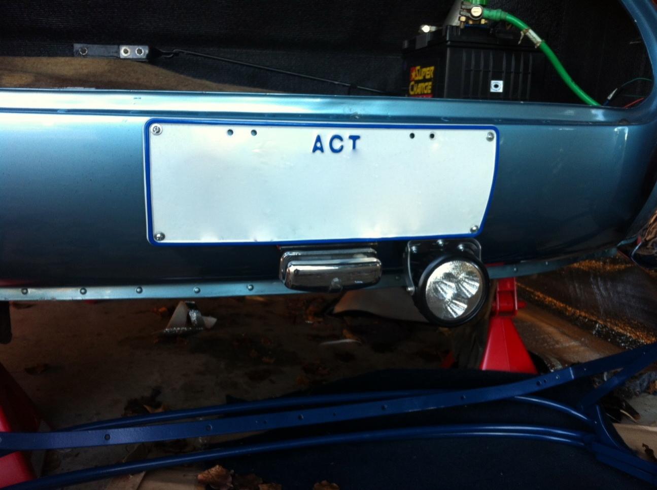

Here's what I used to attach mine - including a mount for a reversing lamp as well as the licence plate lamp.
I used a thin strip of mild steel which is bent with a double bend - to lift it away from the body and to change the angle to a more vertical plane, as the body is at a significant sloping angle at this point. The Licence plate light is screwed to an aluminium sheet which uses the same two screws, and sits over the steel piece. You can see I've added a small plate at the bottom edge for the reversing light. I had the steel powder coated, and its mounted over a thin sheet of rubber to protect the paintwork.
Then I screwed the bottom of the licence plate to the steep strip, and to make it follow the shape of the panel I bent the plate by hand (our plates are thin aluminium) into a smooth vertical curve. Then I screwed some small rubber 'feet' to the top holes on the plate. The light tension of the plate against the trunk panel stops the plate from moving/vibrating.

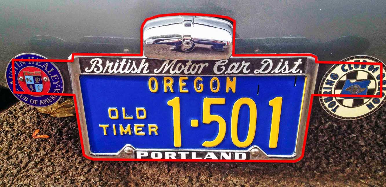

OK, here are a couple of snapshots of my bumperless 100's rear license plate mounting apparatus:
I drew a red line on the first photo to show the general shape of the sheet of aluminum that is attached to the small mounting bracket on the car, and to which the license plate (and license plate frame), license plate light and the two badges are attached. You drill a couple of holes for the license plate light and cut a slot from the edge of the aluminum sheet for the wires (this prevents you from needing to disconnect the license plate light wires). I added the two "ears" so that I could mount the badges. The second photos shows what it looks like behind, at least as much as I can show without dismounting everything. I did start with the small, original plate mounting bracket, so if you don't have one of those, you'll need to find one or make something similar.
Not sure how clear this is or if it's of any help; let me know if I've only confused you or if you have questions.
