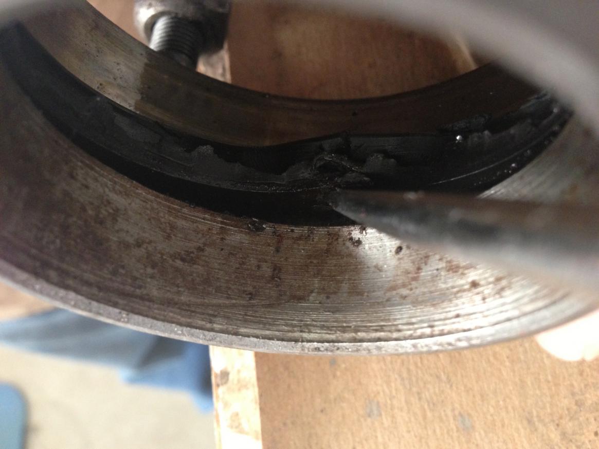

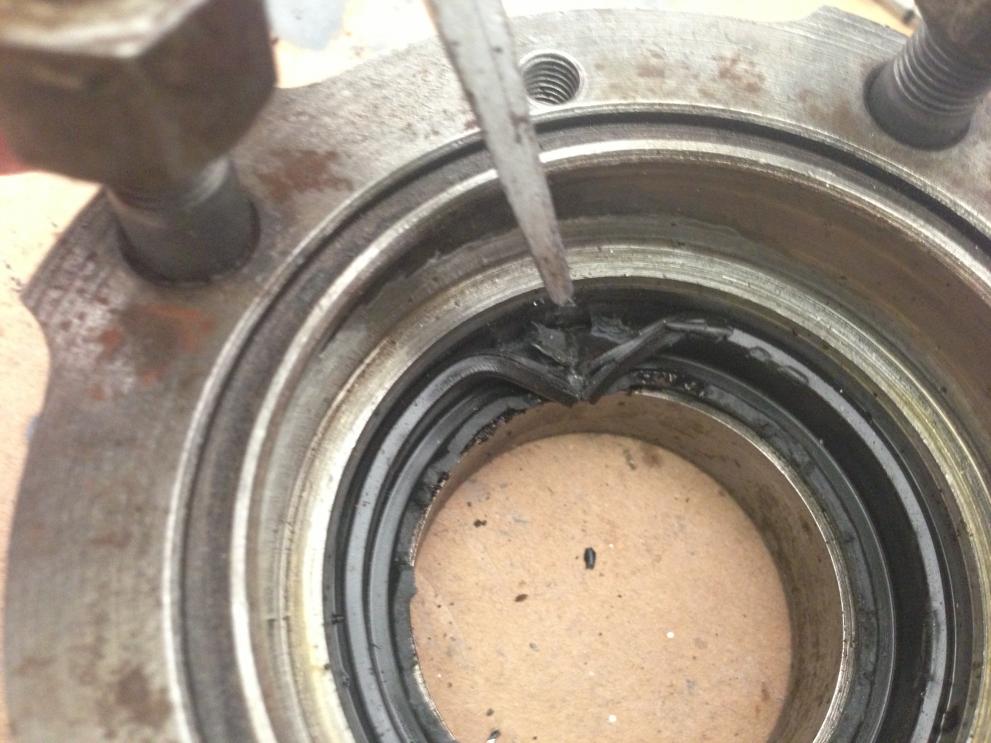

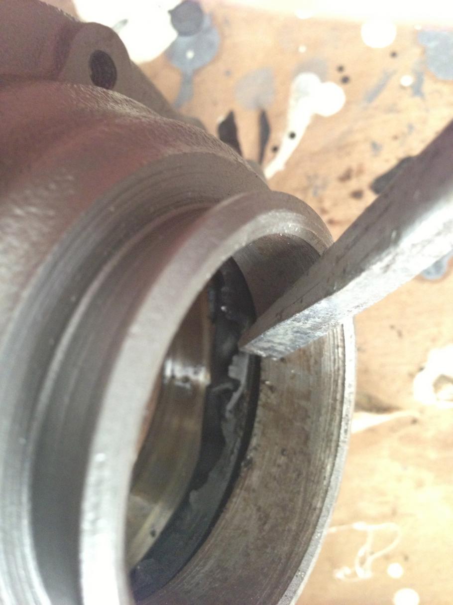

7. Now remove the oil seal. This is tricky because there is no way to get purchase on the metal part of the seal, just the rubber. I used a small cold chisel and small flat blade screwdriver as follows:
a. cut away the rubber lip of the lip seal (I used the chisel).
b. drive the small flat screwdriver blade between the outer metal (covered in rubber) rim of the seal and the hub. Pry the rim inward
to create a small bend allowing you to...
c. use small cold chisel to flatten and partially cut the rim of the seal.
d. Turn the hub over and use the chisel to get purchase on the flattened area of the rim you just created. Tap it outward until you see
a gap develop between the seal and the deep mating surface of the hub.
e. insert the flat blade screwdriver in the gap above and go around the circumference prying the seal away from the deep surface. It
will soon give way and drop out. SEE THE PICS I've attached.
