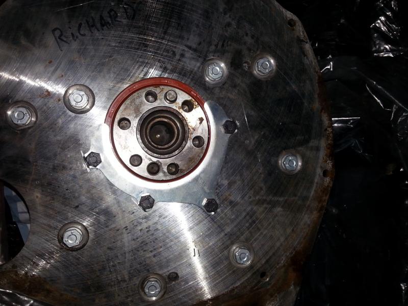

I'm seeing some have the rear main seal retainer. Seems like one of three things is possible
1 I misplaced mine
2 some one else has been in this engine before me AND lost it ( not to likely)
3 only earlier models had one.
The large bolts are 9/16 and have lock washers no tabs I remember or came in my nwip set.
The bently manual is surprisingly un helpful when it comes to the rear plate. Probably because it should be a cake walk
And I'm complicating it
All 5 mains had the seal retainer and later 5 mains did not have lock tabs. Very shallow head bolts and locks. The longer 3/8 bolts with the thicker heads are at the top of the backplate.

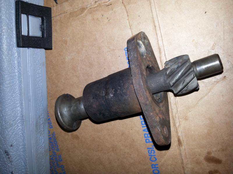

well I figured out why I didnt remember this plate at all. I left it on for the machinist. Found it in the box of old bearings and valves. I also found this guy. I know its not mine...
