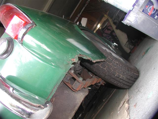

I'm looking for the piece behind the RR tire going up to the seam under the RR tailight. Usually that something that typically rusts out. But if it is good I can use it for Bugsy my '68. here is the small piece I need, Rest of panel is good. Left side I could use as well if it is good. Some bondo in there but otherwidse is still looking good . A future repair, Curve is just a little tricky to fabricate.

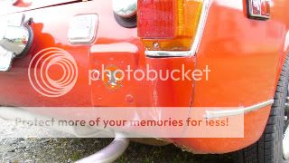

Odd...they did a really good job with filling in the side markers. Wonder why they didn't make fillers for under the tail lights too?

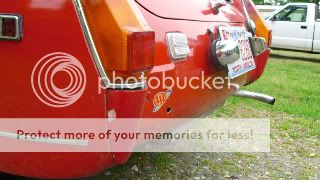

Appreciate the compliments, Kellysguy.... I figured the car has been bastardized already with the 1275, so why not go a little further with some modifications to the body. I'm trying to see if there is a way to make the tail light pieces reversible, in case I ever want to put the RBs back on (not likely). It would be nice to keep it as an option. I've seen some that are styro-foam and fiberglass that are glued on. Maybe I can fasten these to the car instead of welding them.

Get a section of mandrel bent u shaped tubing and make them from that. Hot Rod did a '57 Chevy about 20 years ago and used that to fill in the gun sights on the hood. It worked great. Holding the U directly in front of you ( just like you see it here), make a straigh cut down the center of each leg all the way through to the bottom. The resulting piece will be the shape of the missing area. Weld flat steel to the back of it and glue it to the car, or drill a hole and bolt it on. No need to weld it to the car.

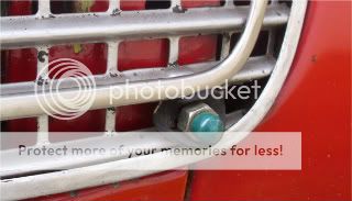

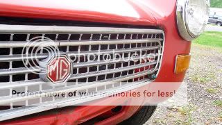

For the front, get a set of driving lights with flat backs and mount them on the bumper mounts by placing the center of the back directly up against the mounting area. Mark where your holes should be and drill hole in the back of the lights to match the bumper bolts. Cut a RWA grill to fit around the frame horns and mount it flush with the back of the lights.

I made bumps out of styrofoam covered with bondo, and attached with trim adhesive. Still attached and looking good a year later.
I took a chunk of foam, carved it to shape, covered it in tinfoil, and bondo'd it over. Primed, sanded, and painted. Quick and dirty, but most importantly, cheap!
For that matter, while we're talking about cheap-and-reversible, my grille is from a '74, painted silver and flush-mounted...
Just by bolting it onto the bumper mounts. Easy and cheap!
