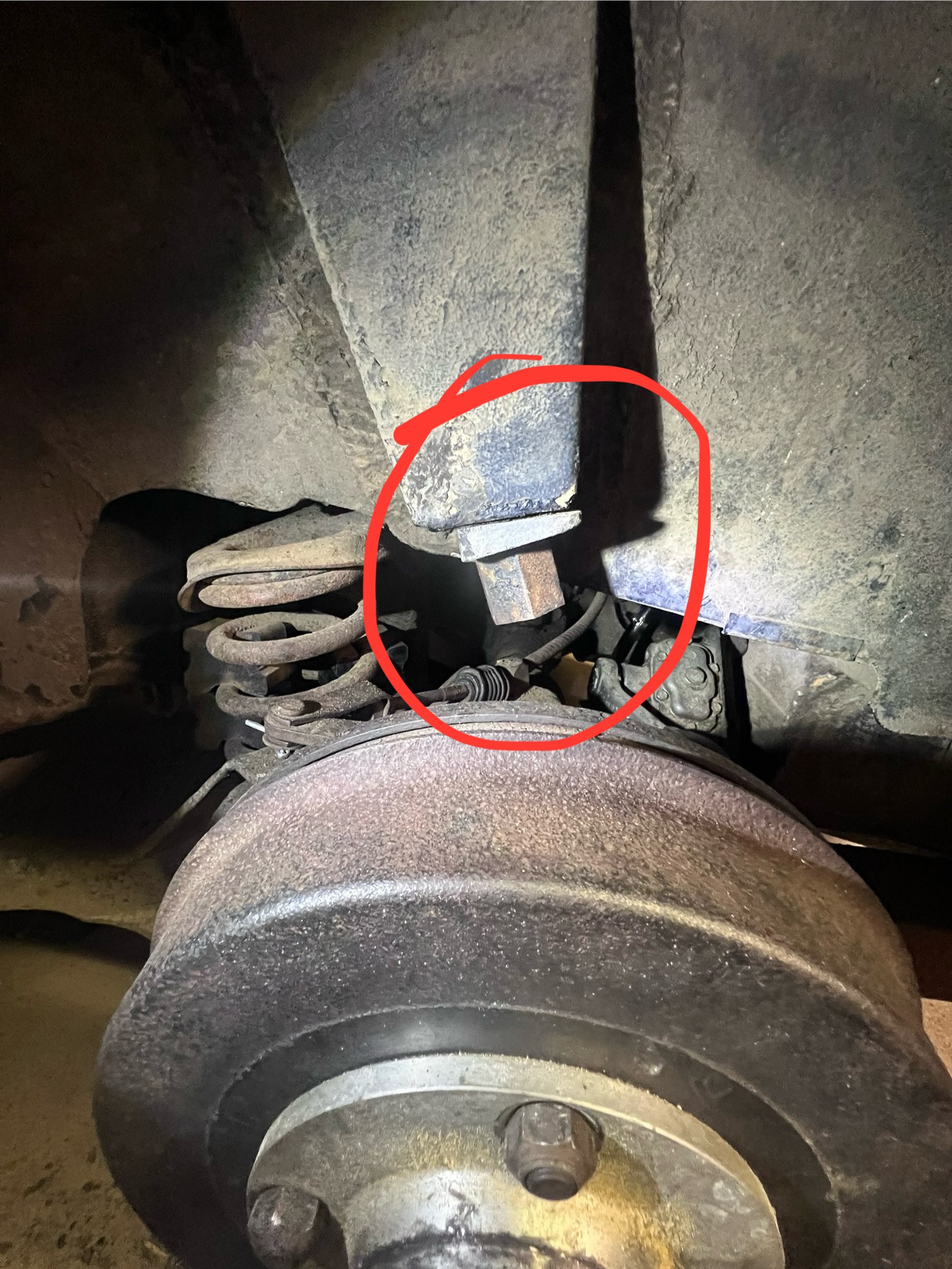

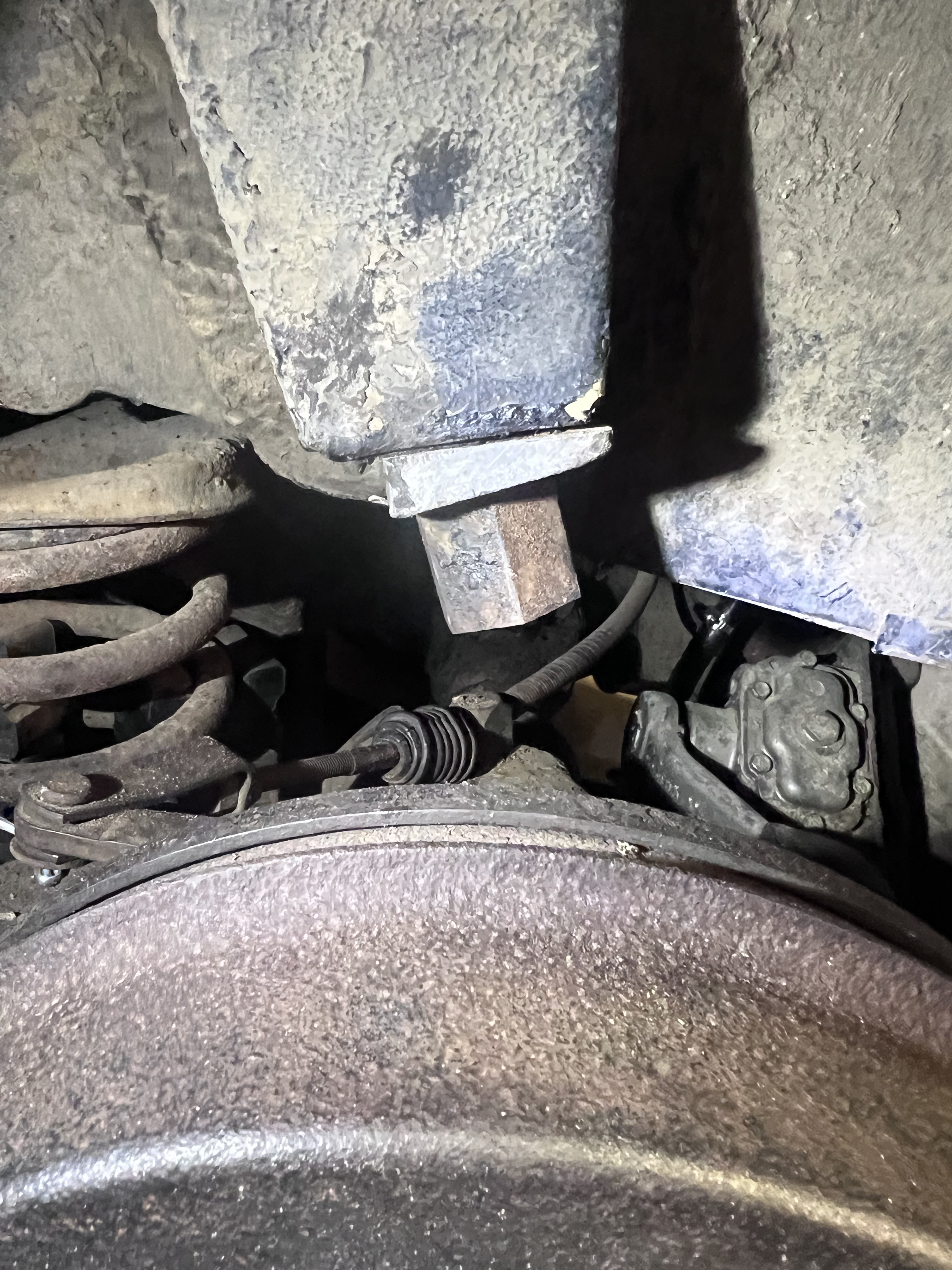

67 TR4A IRS, rubber bump stop was worn down and crumbling. Bolt snapped and now fighting to extract. Looking for how the large nut and wedge shim mounts to the body. The mount cavity cannot be accessed from inside the cabin (pulled the interior from wheel welll), nor the truck compartment. Has anyone disassembled this piece? I don't see this assembly in exploded view diagrams. Only can find the bump stop itself.
Thanks
Donn

Drill a 3/16 hole in the extrusion the bolt goes into then fill the cavity with weasel pee. Is this piece #20 on the Moss diagram?
Bob
It is part 20 which I ordered prior to removal but the stud snapped and an EZ did not work to remove the broken stud. I’m asking if anyone know how the hexagonal section and shim mount to the extrusion. Has anyone cut that extrusion open to see how it mounts. This section I’ve not found in the exploded diagrams. Thx
