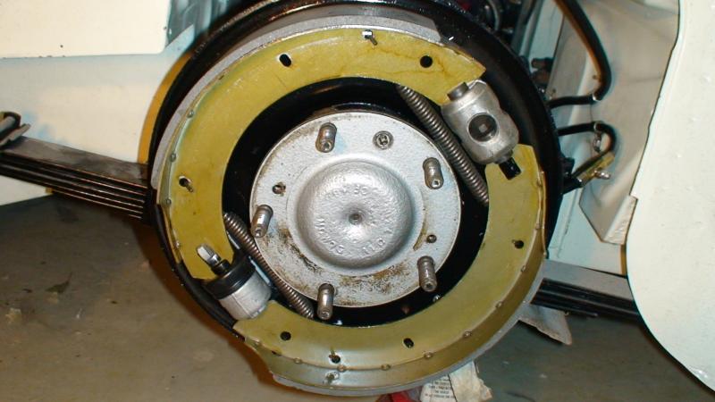

In my battle with the brakes on my BN4 I now have another issue.
I have replaced the shoes all cylinders etc and I have some brakes now that feel ok.

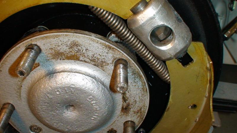

BUT, the springs on the rear shoes are very close to the hubs, so much so that they touch and make a horrible noise when the wheel turns. They didn't do this when I drove the car before.
I've measured the hole distance and compared to the old shoes and they are the same. This really has me flummoxed! Am I missing something really obvious here? There is very little room for the springs and I really can't see how they can go any other way. I have attached a couple of pics to show the problem and the way I have assembled the shoes. Perhaps someone can tell me if I've got it right. The only way I can see is to fit narrower springs, but these were on the car and were fine before.. . . HELP!
Thanks
Matthew--
Strange indeed as if the holes are in exactly the same positions the springs should fit as before.
You mentioned you replaced "all cylinders".--are they the same size as the earlier ones?
Also, is this happening after you have adjusted the shoes, which will put more tension on the springs and in effect make them narrower, if only very little?

Yes, I have adjusted the springs. I have seen some springs that have a single wire in the centre. I suspect that's what I need, but it's weird how it has suddenly become a problem. Thanks for the answer.

As Michael mentioned, with the worn shoes the springs would have been stretched a bit. You do need the correct springs
though, with no coils in the center. Check the Moss catalog for pictures. Front springs were full coil, as were those on early 100 cars, so there may have been a mix up there.
Bob

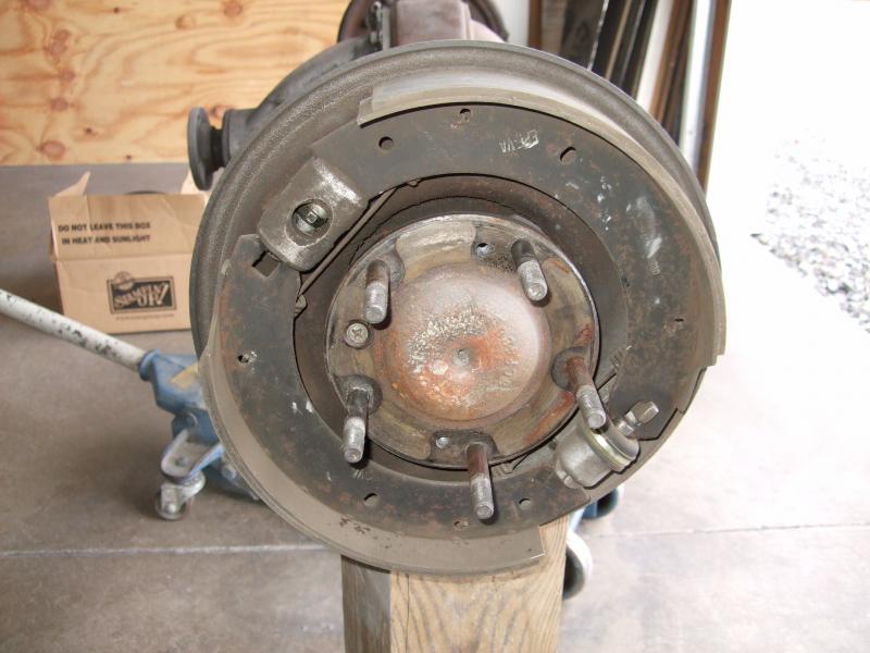

Here is a pic of what I have been using.

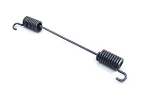

Take a look at the rear brake pictures in the Healey Service manual. As Vette's picture shows, the center of the retention springs have a straight section with coils at each end. As I have always understood, this setup provides sufficient space to eliminate contact with the hub. I appreciate that Moss may have changed the configuration of the spring to allow it to share this piece with other cars,
Personally. Personally, I would look to another vendor to find the springs pictured in Vette's picture and in the Service Manual and return the springs you have.

Ray, I believe his is an earlier model (BN4) which does not have the straight spacer between the spring ends. I believe he took off the springs he is trying to reuse so they should have fit. I am still thinking he has the wrong shoes. I would address this to Dave Nock at British Car Specialist. His family has worked on Healeys for 60 years and seen it all.
All rear drum brake shoes and springs are the same for hypoid axle equipped Healeys which covers late BN1 through BJ8. The OP has his shoes installed correctly but the springs are incorrect. They would appear to be the springs for the rear brakes of the early BN1 with the spiral bevel rear axle. The solution is to simply install the correct rear springs which are shown in the picture posted by "vette".
Matthew,
The springs that your are using do not appear to be correct. Typically, these brake shoe springs have a single wire for the mid section of the spring wit the coil portions only on the ends. I know that doesn't help understand why they were working previously. As the old shoes wore they would have been opened more and that may have been enough to get the clearance to not have them interfere with the hub. I would check that the appropriate springs are being used and also double check that the shoes are correct. I hope that helps..... Tony
