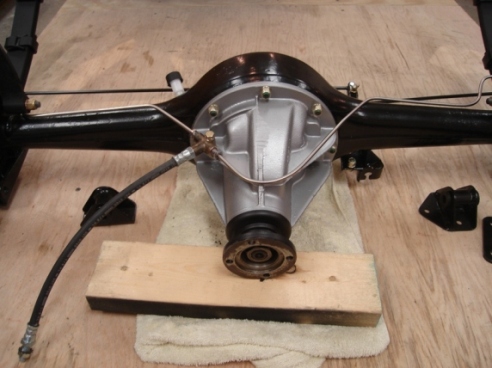

This is not my car, but it should be something similar. Hard pipe for the brakes connects to the bracket at the tunnel, then a flex hose connects to the Tee on the diff housing.

Here is a pic (hopefully) of the rear lines.
Hope this helps.
Note I have not yet added the straps that secure the
brake lines the the axle housing....
Paul

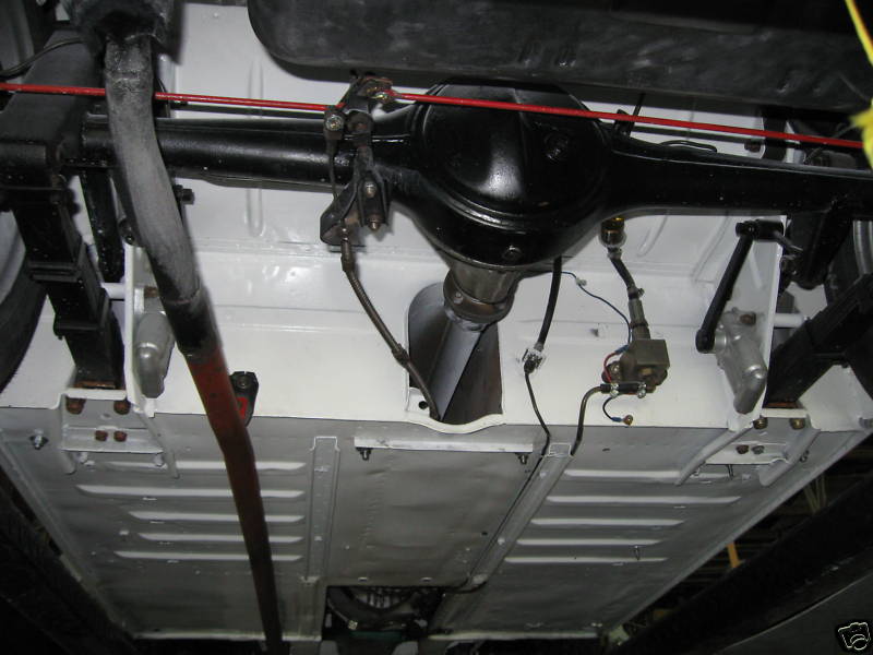

He needs to build a chassis bracket to hold the other end of the flex line... can ya post a photo or two of that?
Here's the best picture I have (from prior to my fuel pump install):
That's what he needs. Thanks Drew!! :thumbsup:
Thanks Drew for the photo of the piece. Luckily the bracket for the pumpkin is still there.
