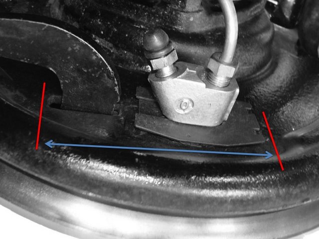

Hi All!
Should the rear brake cylinder be centered within the plate slot, or should the cylinder be down all the way against one side?
Thanks,
Bob
Looks right in the picture to me.---Keoke
The cylinder is designed to slide within that slot in the backing plate to self-adjust.

So they are designed to slide in the slot. I guess that's good, because that is what mine were doing when I pulled the rear drums and pads and then re-installed.
I am not sure I am adjusting the rear brakes correctly? I have new cylinders, new pads, new drums, etc...
When I tighten the pads I start to hear a scraping sound like there is a high side to one of the pads? When I hear this, I then back off the adjuster by 2 flats and the wheel spins freely.
Shouldnt I feel a real good resistance on both shoes as I tighten, then back off 2 or 3 flats??? If I do this, I then still hear a bit of scraping on one of the pads...? This is what lead me to question the position of the cylinder in the slot on the back plate...
Any advice is appreciated!Thanks,
Bob

This is getting very interesting! Actually, on the right side, where I hear the slight scraping noise (like there's a high side to one of the shoes...), I know I am missing one of the felt bushes. In the mean time, I ordered 4 new ones and have rec'd them.
I guess I will pull the drums and shoes off again and install the new bushes and especially install the one that is currently missing on the right side. Then readjust and see if I can get the shoes more even and adjusted correctly.
Amazing how that little booger would be the issue.
What a great group this is!
Thanks guys!!!
Bob

I installed new brake cylinder clips, along with new rubber boots and new small felt bushes behind the shoes. I also applied some grease (came with the new clip kit from Moss) behind the cylinder (like in Randys picture above). This helps the mechanism to slide in the plate and helps to center the shoes in the drum.
I readjusted the brake shoes and the overall braking is improved! Andy, I used your idea of the small screw drivers to hold back the clip tabs and that worked great, thanks!
There is still a slight high point on one of the shoes, but I think as I put on some miles and then readjust, it'll be fine.
