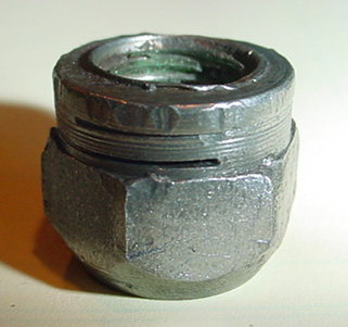

I have attached a pic of the correct lug nut. Note the slits just below the top threads. The top threads are actually deformed to make them bind. This particular example is worn beyond use. As I said above, make sure they are tightened to 55 ft lb & check once in a while. If they loosen even a bit, it's a short time until you are screwed!

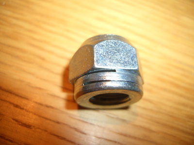

Dave - thanks for the info and photo. There's an old saying, you don't know what you don't know. Upon closer inspection, the ones I got from VB do have the slots like the one you showed. See attachment.

Oh, I was going to ask - does this mean that I should not use Loctite when I put the new nuts on?
