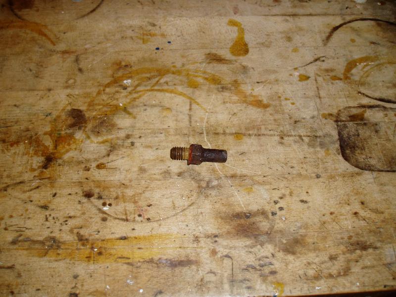

Here's what it looks like, and they are always plugged:

Hi,
I popped the vent out and it was plugged. Its basically a 3/8 bolt with a 1/8" hole in it. Nothing to filter out the water or dirt that I can tell. I cleaned it up and slipped a piece of hose on it like Merlin suggested. Its got to be a lot better.
