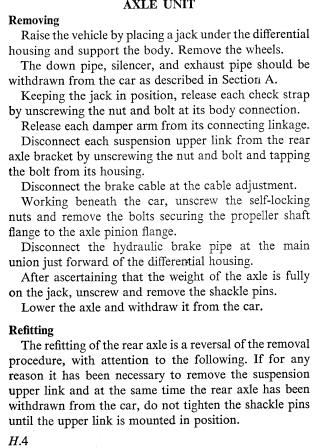

Just go ahead and wing it, that spring is not going anywhere, Car on stands and jack under the differencal. Just take the weight off axle when you unbolt so there is no tension on the bolts..
Paul, here's the pertinent section from the manual. I find it easier to do it this way and remove the springs from the body separately.

Oh yes, all out then springs.
Thanks Jeff & Jack!
I'm on my way out now and will print the intructions. We'll see how far I get.

Thanks for the manual link.
I got the axel, springs and dampers etc out today! Actually, I got every bolt and nut removed yesterday (in about 2 hours) except one final bolt linking the axle and the springs. Returned today with a Bigger Hammer and punched it through. Then removed the rest. Things are very solid on the body. Put penetrating oil on the front suspension and hope to remove it next. I know this was recently discussed. Wish me luck. Hope to have the car on stands by the weekend.
