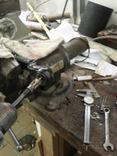

Use a adjustable reamer from Harbor Freight that I barrowed from a friend. Worked great once I figured it had to be run counter clockwise. Easy job in about 4 steps and great finish inside.

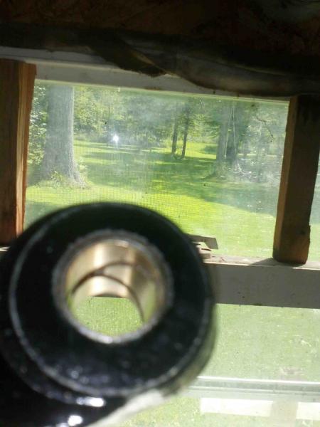

Wasn't hard. first one took 15 minutes then the next 3 took less then that combined. I have a machining back ground in vocational school only and haven't reamed anything since the late 70's. Must be like riding a bike and came back to me quickly. I like saving the money and time. Went back together and is very solid.
