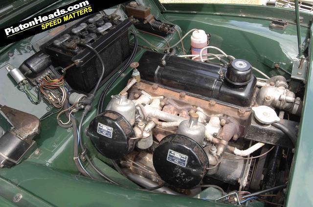

Is your car a TR2 ? What is the TS number ? If it's an early TR2, the valve cover should be painted black. That's the way they left the factory. See attachment.

[ QUOTE ]
[/ QUOTE ]
Actually, in Bill Piggots book, he states that in April '57 at TS18230E, is the offcial point at which the black painted rocker covers were chromed for ALL markets. He also states that possibly all US market cars had them from the start of TR3 production at TS8637 (Oct '55).
Being that your car is a '56 TR3, I guess it could go either way, but if you want chrome, that would be appropriate. Personally, I feel that the chrome valve cover adds alot of flash to the engine compartment.
